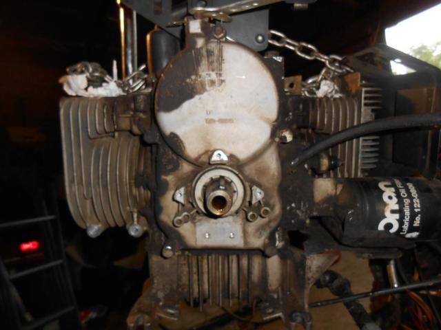

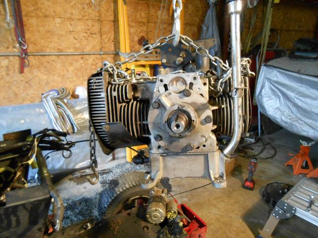

coldbear 29 #1 Posted May 9, 2015 Hello Fellas.....I just purchased a 1989 520 H with close to 800 hrs. on her. I bought her cheap enough that I can afford to rebuild her right. She needs one piston, a rod, and a cam. My question is there anyone that knows how to read these Onans? I've overhauled several Rotax sno engines in my times but this Onan is a strange bird to me. I live around the Cincinnati area and can travel to a reliable machine shop that can bore and R@R new the valve/valve guides. Any suggestions as who would be a good rebuilder ? Share this post Link to post Share on other sites
boomers_influence 106 #2 Posted May 9, 2015 cold with only 800 hrs SHE should not need a rebuild. i stock any and all parts that you will need for this repair. many of my customers do it themselves. please have cast # from the rod side beam, and inside of the piston. also the spec# and S.N. boomers_influence@yahoo.com 651 437 2826 M-F 10-7 S-S 12-6 cent time zone. thank you. boomer ( the used onan engine parts guy, also NOS and new ) Share this post Link to post Share on other sites

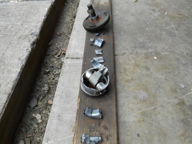

coldbear 29 #3 Posted May 10, 2015 (edited) Thanks Boomer for I haven't the vaguest idea how to fix this mess. The internal damage was severe enough to break the cam , one connecting rod, one piston, and nipped the bottom of one cylinder, and nick one throw of the crankshaft. The seller said it still run after this influx but I seriously doubt that. Yes sir, see if you can locate of few internals for me. I always wanted one of these models but now , I don't know. Oh by the way...we used to make the trip up there for the Fall MSA sno-show. I've been by your house many times and never knew it.lol. Edited May 10, 2015 by coldbear Share this post Link to post Share on other sites
