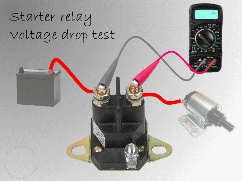

Save Old Iron 1,573 #11 Posted May 8, 2015 (edited) I just assumed that it either works or it doesn't. Is there some other analysis or trouble shooting that I could do on the solenoid to ensure that it is working as it should? Issues with a starter solenoid can arise when the internals of the solenoid become pitted and vaporized from repeated high current arcing. This is a very easy condition to check by measuring voltage drop across the solenoid terminals. Set your meter on low volts scale (2 volt or 20 volt scale). Connect one lead of the meter to each of the large terminals on the solenoid. Crank the engine with the spark plug temporarily disconnected. Note the voltage reading on the voltmeter. Whatever voltage you see on the meter is indicative of a power loss in the solenoid - power that should be going to the starter but is being dissipated as heat in the solenoid. Typical voltage drop in a solenoid should be much less the 0.5 volts (half a volt). If you see one or two volts dropped across the solenoid, a replacement is needed. Edited May 8, 2015 by Save Old Iron 7 Share this post Link to post Share on other sites

AKincer 6 #14 Posted May 12, 2015 Well I didn't disect the old solenoid (like Save Old Iron did), but I did replace the solenoid as I noted voltage drop under load that was higher than I liked. I was seeing about .5-.6 volts across the solenoid posts while spinning the starter. I replaced with a new solenoid and found the voltage drop to be steady at .05 volts across the posts. Now it spins over and starts just fine. My guess is that these big Kohlers need everything working just right. On the smaller engines, maybe the .5 volt loss wouldn't cause a problem, but on this guy it needs everything it can get. Seems to be working fine for now. Will report back if anymore problems. Thanks to all for you help! 1 Share this post Link to post Share on other sites
Save Old Iron 1,573 #15 Posted May 12, 2015 Well done. You isolated an issue with logical troubleshooting instead of guessing and waiving your wallet over the problem. You can also use that exact same voltage drop technique to check the quality of the battery cables. You may find additional 0.5 volt drop(s) across both battery cables or the battery ground cable bolted to the chassis. 2 Share this post Link to post Share on other sites
Save Old Iron 1,573 #16 Posted May 12, 2015 On the smaller engines, maybe the .5 volt loss wouldn't cause a problem, but on this guy it needs everything it can get. The .6 volt drop was more than likely an average drop seen by your voltmeter. I can guarantee the drop during the compression cycle in the engine was 2 or 3 times the average drop. 1 Share this post Link to post Share on other sites
