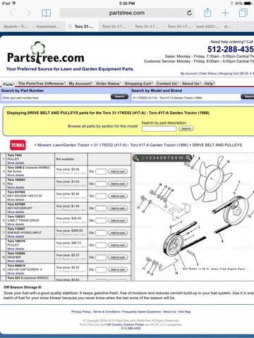

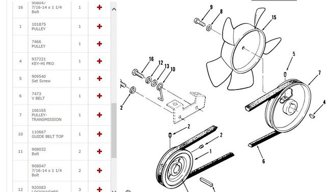

daveoman1966 3,884 #3 Posted May 3, 2015 (edited) the belt s/b # 7473... here is the schematic. Edited May 3, 2015 by daveoman1966 1 Share this post Link to post Share on other sites
rexman72 210 #4 Posted May 3, 2015 Dave thanks for the info as I just looked at what was on the tractor for a belt and then looked at partstree without looking down at what tractor the belt fit.Also checked the pto brake and found it was very low and will cut up some brake pad and make one.Thanks again Share this post Link to post Share on other sites
dennist 139 #5 Posted May 3, 2015 This is different I believe the belt you already have is the one you want? http://www.partstree.com/parts/toro/mowers-lawn-garden-tractor/31-17ke02-417-a-toro-417-a-garden-tractor-1986/drive-belt-and-pulleys/ Share this post Link to post Share on other sites
