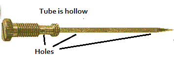

rmaynard 16,700 #11 Posted May 1, 2015 Reset gap to .020. Did you remove the main jet needle valve and clean the inside of the tube and all the holes? You must be able to pass air through the length of tube and all holes. Share this post Link to post Share on other sites
chorusguy 227 #12 Posted May 1, 2015 Yes did that. Two holes by the threads two holes midway one hole at the point. As it is mid behaving it cycles through better running and poor smoking running. Reset the gap. Share this post Link to post Share on other sites
