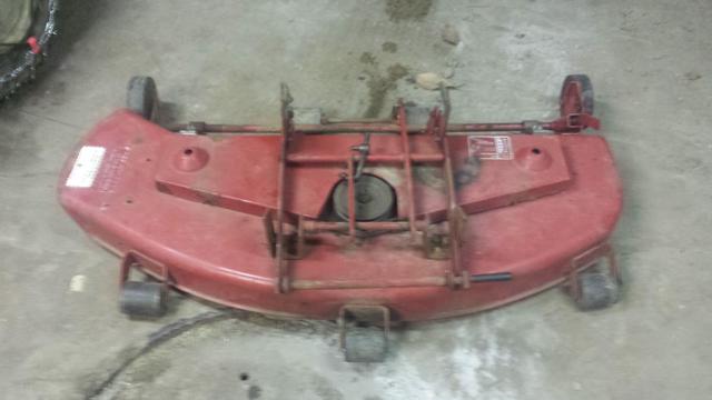

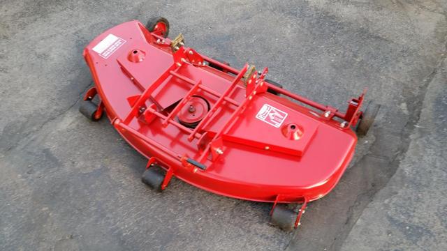

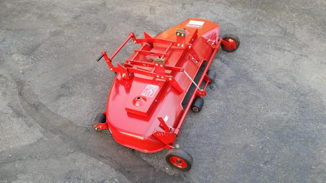

bgh5469 17 #1 Posted April 30, 2015 Guys, Wanted to share my first attempt at a Wheel Horse restoration. Last fall I picked up this 48" deck from a fellow red square member. This deck was intended to replace the completely worn out original deck on my D-160 that has been passed down from my grandfather to me. I figured i would try to redo just a deck, before trying to redo the whole tractor. My ultimate goal is to do the entire tractor. It took me most of the winter to complete and i have to say i am pretty happy with it. I disassembled every piece and ended up stripping and sand blasting the whole thing to bare metal. The deck shell was first painted with Por-15 before painting it red. All of the hardware was replaced with new stainless steel. Now I am afraid to cut grass with it fearing i will mess up my new red paint! Deck before work. Complete with new decals Back on the D! 4 Share this post Link to post Share on other sites

bgh5469 17 #6 Posted April 30, 2015 Thanks everybody!! With the Por-15 I only used it on the deck shell. I read that you need to roughen it up really good, so the paint will stick. I block sanded it pretty good to roughen it up, then primer and paint on top. I hope it holds up. It seems like people either love or hate Por-15. This was my first time using it. My brother raves about, he uses it on his Jeep. Share this post Link to post Share on other sites
