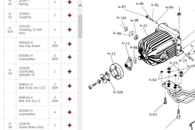

daveoman1966 3,826 #4 Posted April 30, 2015 Are you asking about the coupler here... item # 53? It is part # 103029 Share this post Link to post Share on other sites
Niagara D 11 #5 Posted April 30, 2015 That is the one. However if they are no longer available, I'm afraid part numbers are not going to help much. Share this post Link to post Share on other sites

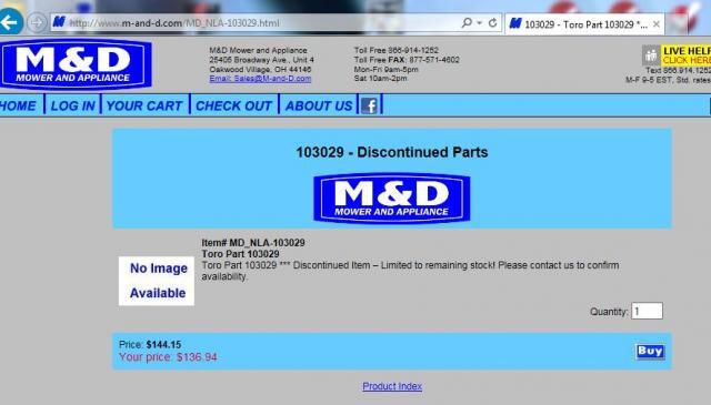

daveoman1966 3,826 #7 Posted April 30, 2015 This place MAY have a coupler....they show ONE REMAINING... price is $ arm + leg . http://www.m-and-d.com/MD_NLA-103029.html In case that link doesn't work, here is a SNIPE of the website Share this post Link to post Share on other sites

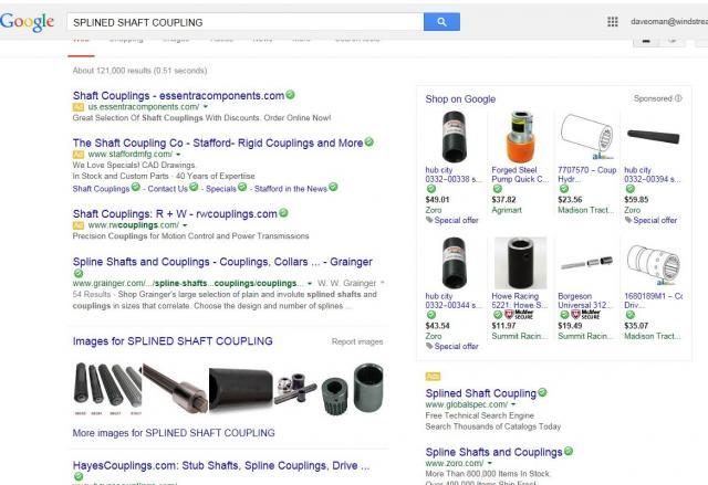

daveoman1966 3,826 #8 Posted April 30, 2015 (edited) I asked my pal Mr. GOOGLE this.... SPLINED SHAFT COUPLING. Here is what Mr Google found. You MAY find a source here for something close, then adapt it. I haven't done any more research on this..... good luck. I'd think that, if you can get the specs of the female spline, one of these sources could match it.... Edited April 30, 2015 by daveoman1966 Share this post Link to post Share on other sites
Niagara D 11 #9 Posted April 30, 2015 Thank you for the time...looking at that gives me the idea to get a splined sleeve and then bore out a stripped 103029 and use a couple set screws to hold it in place. I will have to measure up the shaft when my spare pump gets here. That is a cheaper option then having a whole unit machined as I can bore it out at work. Share this post Link to post Share on other sites
