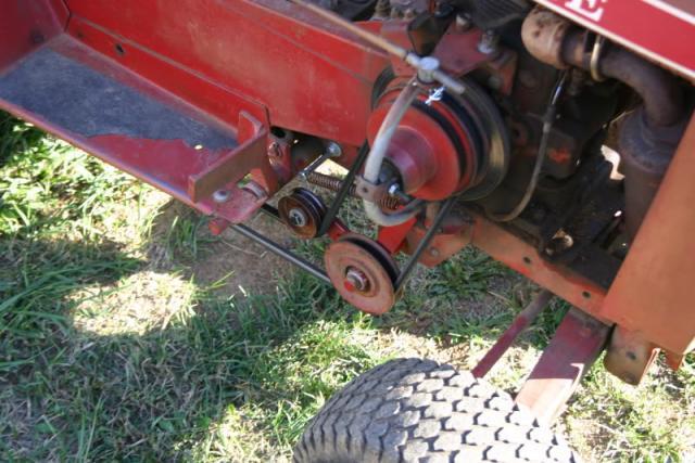

jsp_333 306 #27 Posted May 7, 2015 Was actually able to use the tiller last night. After getting a 2 1/4" idler and flipping the spacer to the inside of the larger pulley to move it and the belt in line with the pto the tiller functioned. Going to have to try the Gates 6686 BR 1/2 x 141 3/8 if I haven't worn out my welcome at Motion Canada. This whole belt length thing is a real mystery. Especially since I haven't been able to find anyone who can measure a belt with a device instead of running a tape measure around the outside of it. A public thank you to Rich (312Hydro) for keeping me going. Next will be getting the correct mid mount pulley so the tension arm is free to operate as designed. How I got this thing working last year with the set up I had is beyond me. The saga continues... 2 Share this post Link to post Share on other sites
bmsgaffer 2,071 #28 Posted May 7, 2015 Just out of curiosity, as I havent read all of this thoroughly, do you have a picture from under the tractor where the bar clips into the attachmatic? Could it have possibly clipped in wrong, which caused it to be too far shifted inboard? (And would also explain how you got it to work previously) Heres a picture I found of a similar setup. It seems as though the lever the spring attaches to should clear the PTO hoop bracket: If this has already been addressed, just ignore me! 2 Share this post Link to post Share on other sites
312Hydro 474 #29 Posted May 7, 2015 I think Brandon has a good point. Shouldn't both of the locating bushings be inside the attachamatic when you look under the tractor? Share this post Link to post Share on other sites
jsp_333 306 #30 Posted May 7, 2015 Ya Brandon's right. Just went out to the garage to have a look and sure enough the locating bushings weren't in properly. I think the problem was my technique. I was crouching down to put in the mid mount idler and trying to do it by feel. Now I got under the tractor got the two locator bushings in proper place. Got it to stay long enough to get a small sledge and was able to easily tap it into place and lock the attch-a-matic. I always thought that was how it should go but it didn't fit easily, hence the sledge, and the spot welds seemed to be in the way. Will re adjust the pulley and idler tomorrow. Gotta go to Karate. John 2 Share this post Link to post Share on other sites
