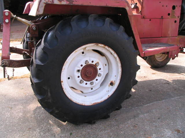

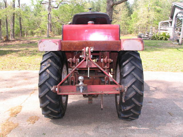

pacer 3,179 #4 Posted April 28, 2015 (edited) I just put 2 American Farmer ags on my D --- this is what they look like... These came off ebay, 2 tires plus tubes at $220 + ship for a total of about $260. I was a bit leery about them but once on I am really pleased! Send me a PM and I'll give you a link to the seller. Edited April 28, 2015 by pacer Share this post Link to post Share on other sites
