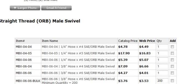

pfrederi 19,446 #2 Posted April 28, 2015 (edited) 100R1AT at 2750psi is ok or 100R2AT at 5800 psi ...but it is less flexible. You need 1/4" but wait till you try to find the SAE#5 ORB fitings especially the elbow ones for the cylinder. You can find the straight ends but notice teh price difference for what you need 1/4 SAE#5 Edited April 28, 2015 by pfrederi Share this post Link to post Share on other sites
