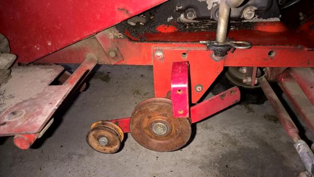

o0Nighthawk0o 2 #28 Posted April 29, 2015 OK, ran into my first snag. I looked at the tiller and it is part number 79271. This is a very new model compared to the C-175. The manual says it is for a bottom PTO. Of course mine has a side PTO. The guy I bought it from gave me a idler pulley assembly. (Picture attached) I checked and the idler pulleys and the pulleys on the tiller line up. My question is, will this work? If so, does anyone have any idea what size belt I would need and what size/type spring I would need for the idler pulley assembly? Share this post Link to post Share on other sites
bmsgaffer 2,071 #29 Posted April 30, 2015 Do you have a pic of the tiller? According to the manual it looks to me like the only difference is the model you have had an extra belt guard with an idler pulley on it... If all that has been removed then it looks like it may be the same. I have not dug into part numbers to compare though. The pulley diameter may be wrong but you could probably find the right size one. Wheel horse was big on using the same "base model" of things and just modifying some ancillary items to fit each application. If all the above does work, then you will probably be looking for the standard tiller belt available from toro. Seeing that the PO got the correct mid-mount idler assembly for the c series (the part in your picture), he probably modified the tiller to work already.... Share this post Link to post Share on other sites
o0Nighthawk0o 2 #30 Posted June 23, 2015 OK. A couple months using my new toy and so far so good. I have used the dozer blade to push horse poop and smooth out gravel in my drive and it worked very well. Just need to add some weight to keep the blade down. I love the rear discharge mower deck. Does a much better job than my side discharge deck. I plowed and tilled a 20ftX60ft garden with it and I will now have fresh veggies. I haven't used the snow thrower yet but in the middle of June that is probably a good thing.I do have one problem. The battery isn't charging. When it's running the amp meter shows a bit on the negative side. I'm guessing about -1 to -2 amps. Not a huge issue as the tractor will run for hours on a full charge but I would like to know if anyone has any ideas.And yes, the above pulley set worked fine with the tiller. I ended up using a 140" belt. Share this post Link to post Share on other sites
