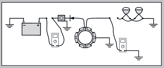

Save Old Iron 1,571 #17 Posted April 28, 2015 (edited) Wish there were 8 days in every week! I pulled an image from the Briggs site showing the regulator in a Briggs dual section stator. I did not see you mention a diode inserted into your test circuit. One version of the Briggs reg appears to be just that, a regulator and not a rectifier. Maybe add a diode in the orientation seen below. I'll take another look at this when the sun comes up. There appears to be at least 3 different types of R or RR units. If yours is an RR unit, from your description, you appear to have it connected together correctly. I said it before, I hate these 3 amp systems. Maybe I lucked out but the 3 amp system on my 211-5 responded very nicely to 2 diodes being added in series with the battery charger wire. On the other hand, its main duty is stop and start cart pulling, not 2 to 3 hours of constant use mowing. Edited April 28, 2015 by Save Old Iron Share this post Link to post Share on other sites
