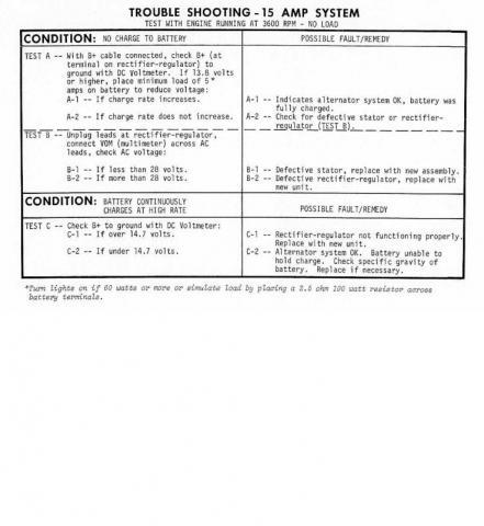

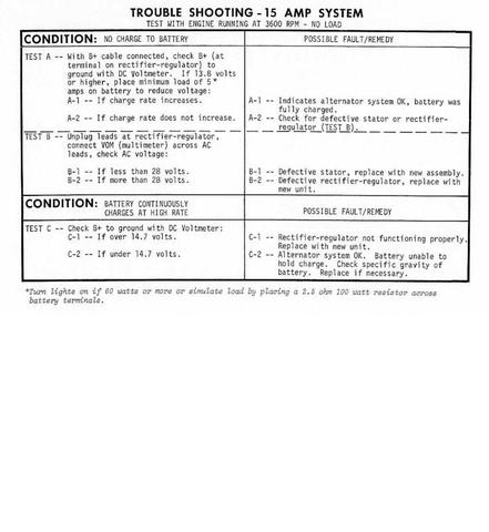

Callen 64 #1 Posted April 26, 2015 Have an SK486 not charging. What should the stater out put be? TIA Chester Share this post Link to post Share on other sites
gwest_ca-(File Mod) 11,990 #2 Posted April 26, 2015 The SK-486 with the Kohler K-341AS-71311A has a 15 amp stator. Garry Share this post Link to post Share on other sites
