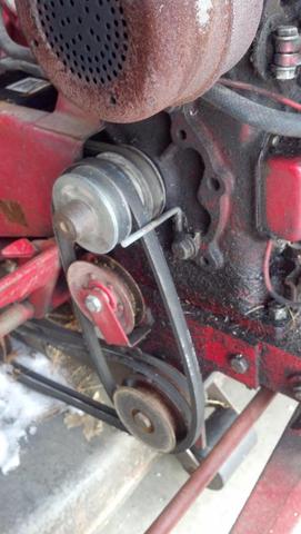

The second is this a good belt lenght?  I tried a 30 in. belt and it was too tight (never disengaged)  Went to a 31, which you can see is too loose?  It does engage and runs the mower just fine, but wants to slip off. Is there a 30-1/2 and should I try that or just stay with 31?  Since I replaced my original engine with a CH270 Kohler, dimensions are not stock any longer.

Belt looks a bit long, but if it works.....?
Does it stay on the pulleys when not engaged?  I believe the stock setup had a retainer on the engine pulley so it didn't come off when not engaged.

I suspect the angle bracket on the idler in the last picture should be at the rear so it captures the belt there so it can't leave the idler.

Thanks for the info!!!!  :)   Now I remember there was a retainer on my old engine.  I'll rig something up because it does want to throw the belt when disengaged.  And the idler pulley does have an angle to help the belt stay put on the idler.
