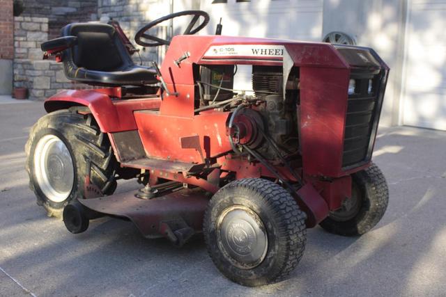

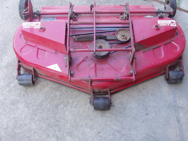

Ramanonos 17 #1 Posted April 17, 2015 Great to see such a big wheelhorse following here! I just got C-125 yesterday for cheap. Estate sale so the seller was clueless about the machine and he presumed it dead. I was able to fire her up with a jerry can fresh gas and a motorcycle battery. So far I'm very happy with this machine. That said, I'd like to get her mowing. The seller had a mower deck, but he was unsure if it went to this tractor or any info about how to hook it up. Has a number of 05-42MR01-34708 As you can see it has a single belt, but I'm unsure how to hook it up or if it can be hooked up. It seems like I would need another belt somewhere to attach to PTO. Any guidance, pics would be greatly appreciated. Thanks! Also, not sure if these are standard cut blades or custom wheelhorse or where to buy them, but they clearly need replacement. 10 Share this post Link to post Share on other sites
bmsgaffer 2,069 #2 Posted April 17, 2015 Nice find! Welcome! That tractor is in great shape! Even looks like the plastic fender is in good shape! That fender cracks and breaks very easy so most here replace it with a steel fender from either the earlier C-series (will fit but may require holes drilled) or the later 300,400,500 series (direct fit, no modification necessary. The deck requires 2 belts. One will go from PTO to center pulley and the other is for the deck spindles. It looks like the deck is missing the tensioner pulley, center spindle pulley and some parts. We have the manual and parts list on here if you search out the part number (on the tag by the rear wheel). I cant see the front, but you will need a mule drive that clips into the front attachmatic to route the belt around the front axle. Blades are standard and someone will jump on here to get you the part numbers (or a quick search might net you the same results). Let me see if I can find you some pictures... Share this post Link to post Share on other sites
wallfish 19,488 #3 Posted April 17, 2015 (edited) NICE SCORE! That deck will fit your tractor but it's missing a couple of pulleys. The double drive pulley and an idler pulley to tension the belt. You'll also need a mule drive which is a pulley setup that attaches to the front of the tractor so a belt from the PTO can attach to the deck. Use the search feature in the upper right to search in the manual section for the manuals you need. EDIT: Looks like gaffer posted while I was typing Edited April 17, 2015 by wallfish Share this post Link to post Share on other sites

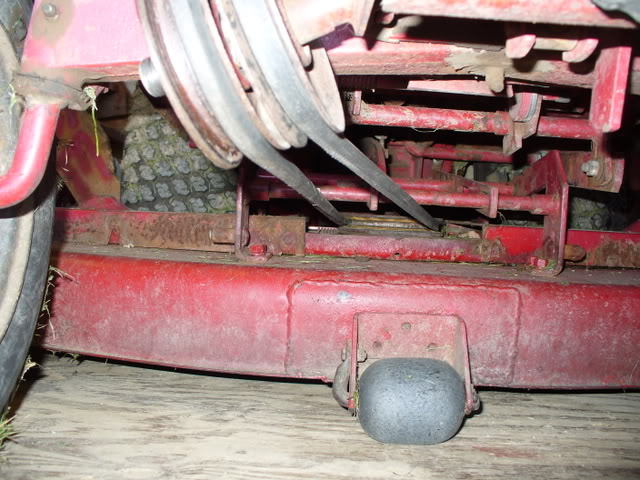

bmsgaffer 2,069 #4 Posted April 17, 2015 Replacement Blades on this thread: Pictures of deck with guards and tensioner in place: Someone will probably have a better pic of the mule drive hook up, but here is the basic idea: Share this post Link to post Share on other sites

shallowwatersailor 3,220 #6 Posted April 17, 2015 Nice tractor! It should polish up very nicely. If that rear fender is without any cracks or damage, I would look for a steel fender as some members probably would love to have it for restoration. The mower deck will need some work plus the mule drive. The estate may still have it and didn't realize what it was. Share this post Link to post Share on other sites
Racinbob 12,844 #7 Posted April 17, 2015 You came to the right place for help. It looks like the guys have got you going on the parts you'll need. Like John said, some of the parts are likely still sitting around the estate and the seller didn't know they belonged to this tractor. I'd go back and see. That is one clean C-125! Share this post Link to post Share on other sites
Ken B 3,203 #8 Posted April 17, 2015 That looks like a real nice machine and well kept. I kinda like the look of the plastic rear fenders myself.. Whatever you spent it was money well spent and it is totally worth getting the missing parts for the deck. That tractor will last a lifetime if taken care of. Take care of it and your son will be handing it down to his kids. 3 Share this post Link to post Share on other sites

Ramanonos 17 #15 Posted April 18, 2015 Thanks everyone! The support here is great. I browsed through the manual and it appears need a belt that goes around here: I suppose I don't quite understand how it the belt system makes a 90deg turn to the mower deck pulleys. A pic of this set up would be great. Could find anything googling it. I'm also starting to think this deck might not go with the c125. I don't see any evidence of a broken/missing pulley(s) on the top here so I'll check out the parts for sale page, but I'm not clear about what pieces are actually missing: Oh, I assume these might be for hydraulic mounts or is that something else? Lastly, she cleans up well. A little carb cleaning and she sounds nice too. Kinda bummed about the mower. If I can't fix it, I'll probably still keep the tractor for other projects. Share this post Link to post Share on other sites

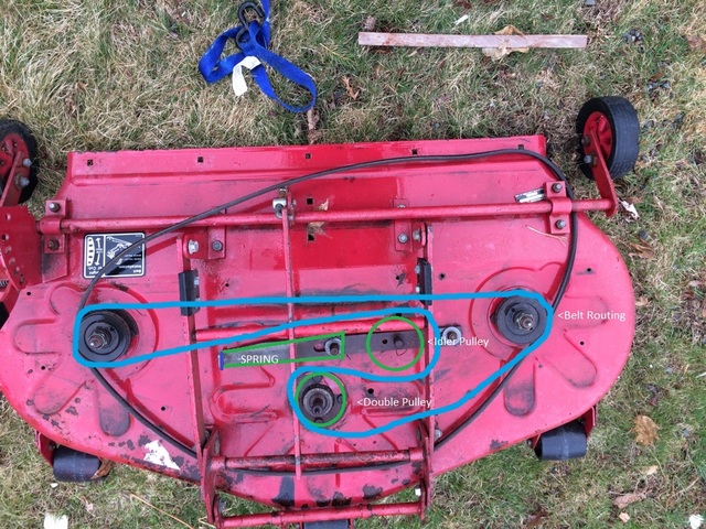

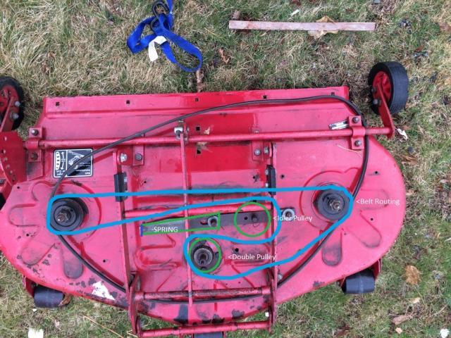

bmsgaffer 2,069 #16 Posted April 18, 2015 I think your deck will be just fine. Blue is the belt routing, green is your missing parts. This is the same deck: 2 Share this post Link to post Share on other sites

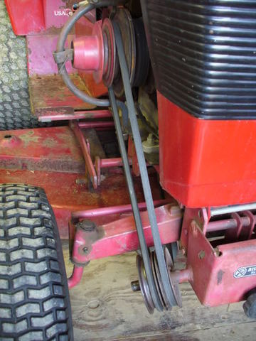

bmsgaffer 2,069 #17 Posted April 18, 2015 Here is a really good post on how to route the belt that you are missing through the mule drive that you are probably missing as well. 1 Share this post Link to post Share on other sites

papaglide 542 #19 Posted April 18, 2015 Real nice tractor you got there. The help here is awesome to say the least! I can't add to what's allready been said because these fine folks have covered it all! Well done boys! Not having the mule drive and just trying to visualize it may make the whole set up seem strange but once you get it all attached the set up makes total sense and it is SIMPLE. Your tractor is a great example of a wheel horse. She can cut grass, snow blow, plow snow, till a garden, plow a garden with a mould board plow, cultivate a garden, tow a trailer or just use her to ride around and admire your yard! Share this post Link to post Share on other sites
Ramanonos 17 #20 Posted April 19, 2015 I love this wheelhorse. I dragged a large fallen tree with ease... Now I have to make her farm worthy. Ok, so regarding the mower deck, it looks like I need a bunch of parts. I couldn't open any of the manual links and also searched online. I'm not sure what these things are or where to get them. I've heard here that I need a "tensionor pulley", a "double pulley", an "idler pulley" a "center pulley" and a "spring". I guess I also need a couple belts (one from PTO, and another on the deck). Anyways, not sure if I need 7 parts, or if they're called different things. I'm hoping it would be clear if I could look at a parts manual and know where to buy. Right now I'm a bit confused. That's ok. Awesome tractor and great support here so I'm willing to stick it out. 1 Share this post Link to post Share on other sites
papaglide 542 #21 Posted April 20, 2015 All of the manuals are in pdf form so you need Adobe acrobat to read them or if you are on an iPad that will read them automatically. Were you downloading the manuals first or just trying to open them? I am pretty sure you need to download first, could b wrong it's been a while since I have done this. You need: For the deck: Idler pulley Idler spring Center double pulley For the tractor: Mule drive PTO belt for a 42" deck The decks might still be able to be bought new from Toro. Your local Toro dealer can/should be able to help you out with this stuff also. Anyways, the support is here if you need it. Share this post Link to post Share on other sites
bmsgaffer 2,069 #22 Posted April 20, 2015 Yep. Mike summarized your purchase list well. Also look into what pacer said. Your deck MAY have been taken apart for a reason (bad center spindle comes to mind) so you will have to spin the shafts and make sure they sound smooth and quiet. Look at the underside of the deck and make sure you see where all 4 bolts attach to the aluminum spindles. Make sure there is no cracks or breaks. Once you get your list, I know there are some salvage guys on here that can hook you up with what you need at a reasonable price. Try again on the manuals. Having the manuals at your disposal will be very helpful in figuring it all out. Wheel horse manuals are pretty good and should get you going in the right direction. Share this post Link to post Share on other sites
