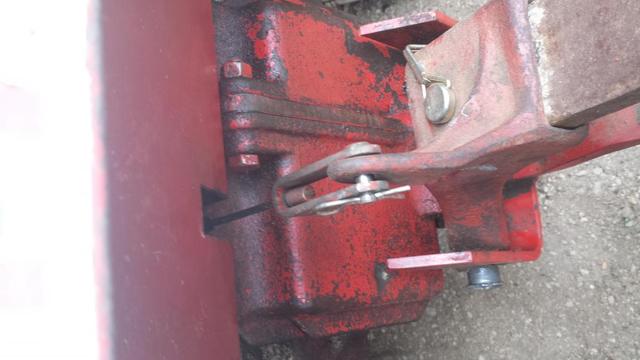

explorer 1 #1 Posted April 17, 2015 update on recent wheel horse I purchased. Installed new battery, cleaned points, changed oil and air filter, installed muffler, it fired right up, used it to drag 940 lb roller on back acre. Ran great, have one question for anyone who knows, what would be the draw bar on the rear has whats left of a cable attached, where can I find a replacement. I only have the cable housing left, ant information would be appreciated Share this post Link to post Share on other sites
daveoman1966 3,881 #2 Posted April 17, 2015 Can you post a pic or two....tough to tell what you are asking about. Share this post Link to post Share on other sites
explorer 1 #3 Posted April 17, 2015 Cable ran through frame and attached to lever that raises and lowers the deck. Did this also raise and lower attachments? Share this post Link to post Share on other sites
turtlehead 88 #4 Posted April 17, 2015 Yes. That cable would connect to your slot hitch and go forward, through tunnel, to rock shaft which is the same deal that raises and lowers the deck. Probably tried to lift too heavy and broke cable. Share this post Link to post Share on other sites
turtlehead 88 #5 Posted April 17, 2015 Here's a pic Share this post Link to post Share on other sites
