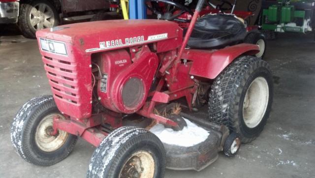

RedRanger 1,470 #1 Posted April 16, 2015 I'm restoring both a RM367 rear discharge deck for my 867 as well as a smaller RM-116 32 inch rear discharge deck for our lawn ranger. Both came to me with small 4 inch guide wheels on the decks. None of the wheels look to be original and all need to be replaced. I can find the Toro part numbers for new ones, but no cross reference as to what size they should be. Are these suppose to be 4 inch diameter or larger 6 inch? I'm thinking a 6x1.75 would look and work better. RM367 shows a 6749 part number RM116 shows a 2877 part number Thanks. Share this post Link to post Share on other sites
gwest_ca-(File Mod) 12,511 #2 Posted April 16, 2015 From my notes the 6749 wheel is 1-1/2" wide x 5-1/2" diameter - I don't recall the source of this. Toro wants about $62 each for this one. The 2877 wheel has been replaced by Toro 110506 and is 1-3/4" wide x 6" diameter https://www.bantasaw.com/catalog/viewproduct.asp?i=&p=359 Garry 1 Share this post Link to post Share on other sites
RedRanger 1,470 #3 Posted April 16, 2015 From my notes the 6749 wheel is 1-1/2" wide x 5-1/2" diameter - I don't recall the source of this. Toro wants about $62 each for this one. The 2877 wheel has been replaced by Toro 110506 and is 1-3/4" wide x 6" diameter https://www.bantasaw.com/catalog/viewproduct.asp?i=&p=359 Garry Thanks Garry. I see the stens heavy duty wheels on fleabay for about the same price as banta. Is one brand better or different than the other? I assume the heavy duty greasable wheels are worth the extra cost over cheaper sealed units? Share this post Link to post Share on other sites
gwest_ca-(File Mod) 12,511 #4 Posted April 17, 2015 Banta is a Stens dealer east of Toronto in Ontario. I believe Napa also sells the same wheels but forget who supplies them. Might be Prime Line. http://www.primelinepe.com/ Garry Share this post Link to post Share on other sites
