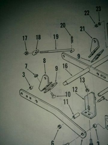

GM_Man 47 #1 Posted April 16, 2015 (edited) Does anyone know offhand what is the length of the wheel leveler rod off a 48" deck. Mine is missing it and I'm going to fabricate a new one. It's #19 in the parts diagram Edited April 16, 2015 by GM_Man Share this post Link to post Share on other sites
gwest_ca-(File Mod) 11,510 #2 Posted April 16, 2015 Sounds like it was a weak link as they increased the rod diameter to 1/2". Download these 3 pages. Sorry I don't know the length. Garry Share this post Link to post Share on other sites
meadowfield 2,756 #3 Posted April 16, 2015 if I recall correctly around 6" - it's adjustable anyway, it's just clearance that's the issue Share this post Link to post Share on other sites
Don1977 605 #4 Posted April 16, 2015 8 3/4" from out side of bend. Threaded 2 1/2". Share this post Link to post Share on other sites
