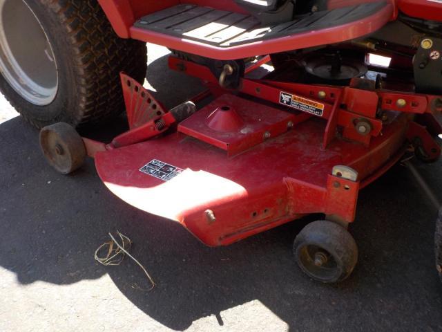

shallowwatersailor 3,220 #5 Posted April 15, 2015 May I express my sincere thanks for the trouble of hunting down this info guys. Huge help!!!! DSCN0260.JPG That, I believe is a 48" Side Discharge. You can save belt wear by removing the belt guide at the front of the deck. A long-time WH dealer shared that hint with me. 1 Share this post Link to post Share on other sites
cbul 0 #6 Posted April 16, 2015 That, I believe is a 48" Side Discharge. You can save belt wear by removing the belt guide at the front of the deck. A long-time WH dealer shared that hint with me. Thanks for the tip and for being so nice to help a guy out ! I'm truly grateful. Share this post Link to post Share on other sites
