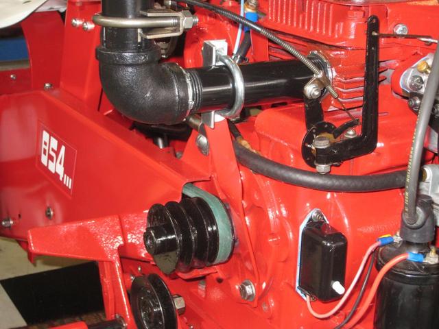

Dan Stewart 8 #1 Posted April 13, 2015 I am looking for suggestions for installing a brace for supporting a heavier vertical muffler and rain cap on my '66 W.H. 606/656. I have items but before installing I have concern of vibration/ weight of unit. Photos, if you have, would be easier than explaining. Thanks for any feedback. Share this post Link to post Share on other sites

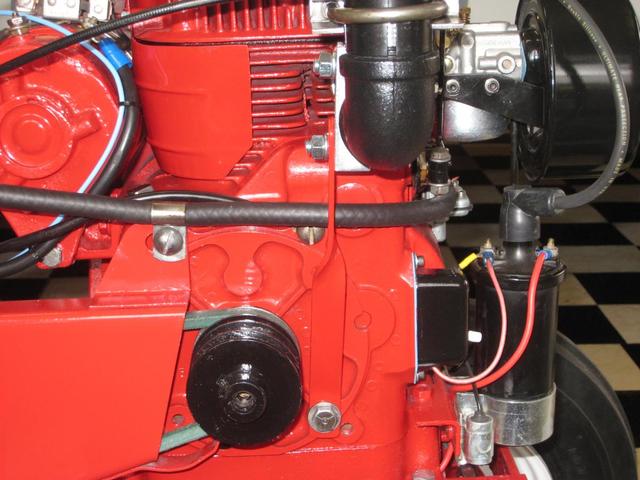

motor12 367 #3 Posted April 13, 2015 Here is what I did on my 854 and it works great Share this post Link to post Share on other sites
JimD 3,347 #4 Posted April 13, 2015 Am I missing something? Is there something not shown in the pic that's tied to the frame or engine block to stabilize the vertical pipe from the clamps where vibration would be the highest? Share this post Link to post Share on other sites
MalMac 1,332 #5 Posted April 13, 2015 Looks like there is a brace from the block to the first clamp. Nicely done. Share this post Link to post Share on other sites
squonk 43,780 #6 Posted April 13, 2015 The paint job is so good and installation so clean you can hardly see it ! Share this post Link to post Share on other sites
Dan Stewart 8 #7 Posted April 14, 2015 Thank you. You have given me ideas and I have some stock to shape a similarity. I have a Honda clone 13hp. from HF. A few twists and it will work. I hope! Share this post Link to post Share on other sites
