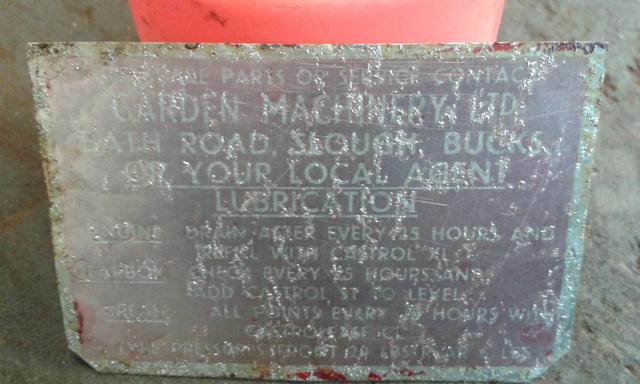

Phyliss 28 #31 Posted April 16, 2015 Good evening. Just thought i'd add a wishy washy photo of the badge that was fixed on to the bonnet of the RJ. Trying to catch the light just right to make it readable was awkward. I've also added it to the UK dealer section. Regards, Philip 1 Share this post Link to post Share on other sites

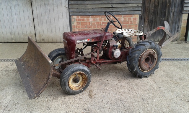

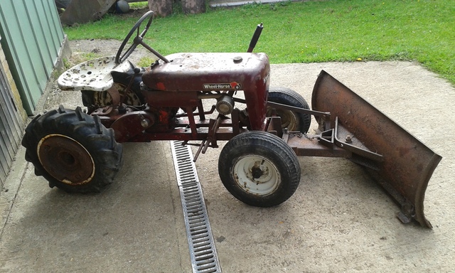

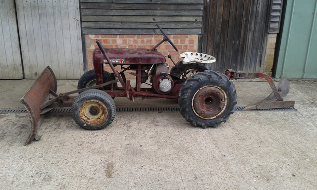

Phyliss 28 #40 Posted June 1, 2015 Evening all, Having acquired the front blade over the weekend i thought i'd share a few photos of it complete; for now. The rear plough is the one that the previous owner used with the RJ & appears to be a Barford Atom item; minus it's disc which may still appear. The RJ will probably go to a couple of shows this year before restoration although sods law it will snow when it's in bits & won't get a chance to use it clearing snow. When the blade arrived home my 5 year old boy was chuffed to bits. His 2 year old sister joined in with the happy jumping, not really understanding why.Regards, Philip 4 Share this post Link to post Share on other sites
neil 2,415 #41 Posted June 1, 2015 Did the tractor ever have the rear fenders & tool box? Share this post Link to post Share on other sites
Phyliss 28 #42 Posted June 1, 2015 Did the tractor ever have the rear fenders & tool box? Not as far as i know but i'll do some inquiries. Share this post Link to post Share on other sites

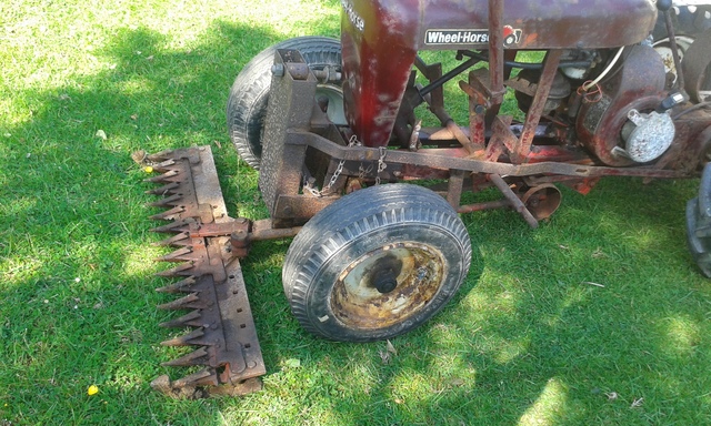

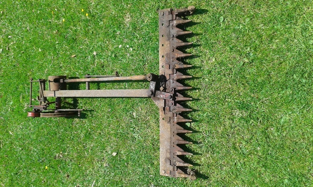

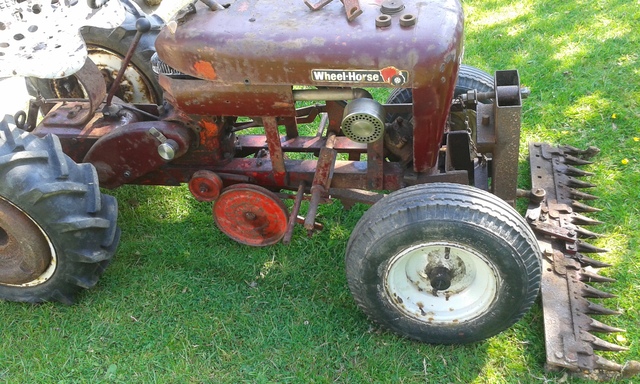

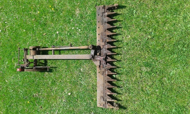

Phyliss 28 #44 Posted June 11, 2015 Hi again, Being a nice day today (at least where i was) i thought i'd loosly fit my recently acquired sickle bar which i think is a CBR-32 but not sure. I don't think it's had much use if any at all going by the idler pulley paint. The pedal & spacers are present & i think these should fit ok on the offside shaft with the clutch pedal. Ideally i should have removed the front blade bracket as this stops it being lifted but apart from that it fits well although snuggly. 2 Share this post Link to post Share on other sites
Anglo Traction 761 #45 Posted June 11, 2015 (edited) Hi Phillip, I'll give you my opinion while waiting to see if any experts can shed any light on the lack of Fenders on your RJ,From what I have seen on here over the few years on here, there are many examples that also have no Fenders, so I would not worry about them. It look's fine without them.Don't know about the Toolbox.Clutch and Brake were modified as you say, they were combined on the one pedal according to many images of the Model on here. Also remained combined through the Suburban Models so it appears.Sickle Bar attachment is a great compliment to the whole package you have. Edited June 11, 2015 by Anglo Traction 1 Share this post Link to post Share on other sites
Phyliss 28 #46 Posted June 11, 2015 Hi Phillip, I'll give you my opinion while waiting to see if any experts can shed any light on the lack of Fenders on your RJ,From what I have seen on here over the few years on here, there are many examples that also have no Fenders, so I would not worry about them. It look's fine without them.Don't know about the Toolbox.Clutch and Brake were modified as you say, they were combined on the one pedal according to many images of the Model on here. Also remained combined through the Suburban Models so it appears.Sickle Bar attachment is a great compliment to the whole package you have. Hello Anglo Traction, As you mentioned there seems to be as many RJs with fenders as without. Regarding the clutch & brake i have noticed a couple with two separate pedals. I did today carefully remove some of the darker red from the 2nd pedal components (pedal, rods etc) & underneath is the lighter Wheelhorse red just like the rest of the tractor. I also looked at the cross piece which acts as a pivot. This is solid square with a moulded pronounced boss for the bolt, not welded. I don't know if it's a Wheelhorse mod or not?Regards, Philip Share this post Link to post Share on other sites
CasualObserver 3,414 #47 Posted June 11, 2015 For what it's worth, your pedal on the right should not be connected to the transmission. These tractors are a single clutch/brake pedal until sometime in the 70s. The right side pedals (many different shapes) were for attachment controls. The one you have mounted appears to be the dozer blade pedal and should have a bit that hangs below the bottom of the 3/4" shaft with a hole to connect the chain that pulls the pin on the front blade so you can index it (swing left of right angle). The top outside corners of the blade should have two little holes and there would be a rope connected with little s-hooks. I don't have a good picture of the pedal on that side (mine is put away somewhere), but here is a picture showing how the rope for angling the blade should be connected. The little chain (which you have) should be threaded through that little hole in the mounting bracket and connect to the right side pedal. When you push the pedal, it pulls the index pin on the blade, then you pull on one side of the rope to angle the blade and release the pedal to lock the blade back in.Additionaly, for what it's worth... there are also different right side pedals for the CBR-32 (which you have also) and the 1960 version of the RMR-32 mower deck. 2 Share this post Link to post Share on other sites
CasualObserver 3,414 #48 Posted June 11, 2015 Oh, and as for fenders and tool box... that was an optional accessory. FA-22 I believe was the part number. The didn't become standard equipment until the 1960 and 1961 models 550 and 551. The 550 needed it as that's where the battery sat. They were optional on non-electric start models. Share this post Link to post Share on other sites
Phyliss 28 #49 Posted June 11, 2015 For what it's worth, your pedal on the right should not be connected to the transmission. These tractors are a single clutch/brake pedal until sometime in the 70s. The right side pedals (many different shapes) were for attachment controls. The one you have mounted appears to be the dozer blade pedal and should have a bit that hangs below the bottom of the 3/4" shaft with a hole to connect the chain that pulls the pin on the front blade so you can index it (swing left of right angle). The top outside corners of the blade should have two little holes and there would be a rope connected with little s-hooks. I don't have a good picture of the pedal on that side (mine is put away somewhere), but here is a picture showing how the rope for angling the blade should be connected. The little chain (which you have) should be threaded through that little hole in the mounting bracket and connect to the right side pedal. When you push the pedal, it pulls the index pin on the blade, then you pull on one side of the rope to angle the blade and release the pedal to lock the blade back in.Additionaly, for what it's worth... there are also different right side pedals for the CBR-32 (which you have also) and the 1960 version of the RMR-32 mower deck. Hi. Thanks for the information re pedals. I did wonder where the little chain went. I had also noticed 1 little S hook on the blade & again wondered what that was for. I can just about see from your photo where the chain attaches to the pedal. I'll see how long my chain is tomorrow. During restoration I may revert back to one pedal to keep it original.Philip 1 Share this post Link to post Share on other sites

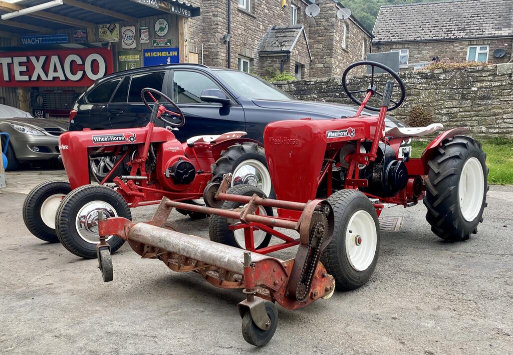

Vaughan32850 86 #50 Posted February 27, 2022 My two original Wheelhorse demo model RJ-58’s 2 Share this post Link to post Share on other sites
