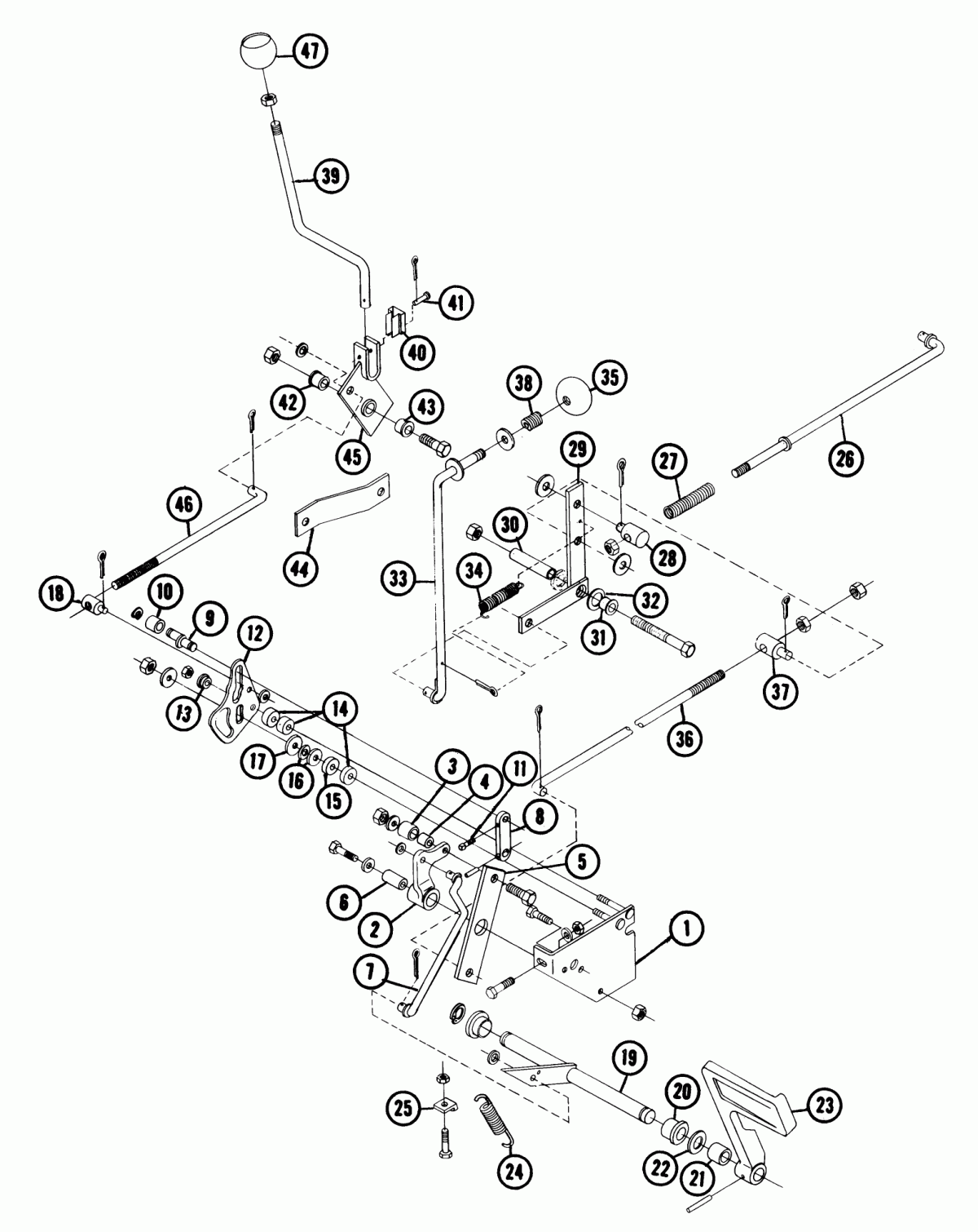

JackC 617 #5 Posted April 11, 2015 (edited) See page 33 of the below PDF or page 7 in section 5. You may need to copy the below into the address bar. The diagram is not that good but it may provide more information than you currently have. http://www.mywheelhorse.com/graphics/file/tractors/tractor_1978_b-c-d-seriesservicemanual_810063rl.pdf Edited April 11, 2015 by JackC Share this post Link to post Share on other sites
daveoman1966 3,881 #6 Posted April 11, 2015 From the Toro website for 1975 D-200 (1-0631) here is the speed control linkage. Share this post Link to post Share on other sites
pfrederi 19,446 #7 Posted April 11, 2015 They changed teh linkage when they changed the parking breake system. Is the slot on the side of the hood stand a single with a jog in the middle or more a y shape with two rearward slots. Early models engaged the parking brake when you pulled the motion control lever into one rear slot it went into reverse when you put it in the other. To add to the confusion my d200 has the y slot but doesn't use it for the brake, there is a separate lever under the dash. Guess they were using old hood stands up. Share this post Link to post Share on other sites
