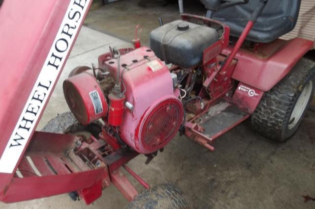

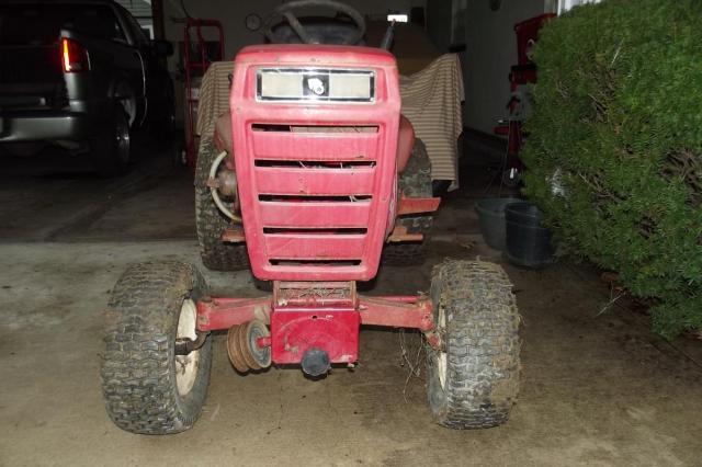

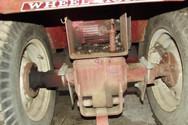

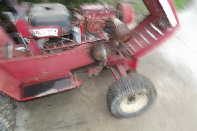

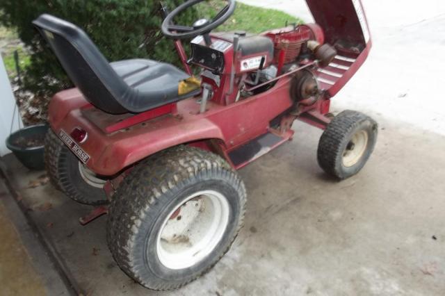

BOWTIE 226 #1 Posted April 9, 2015 JUST PICK UP A 1976 C120 AUTO TONIGHT 4 MILES FROM HOME. I GAVE A $100 FOR IT. PO SAID IT RUNS BUT NEEDS A FUEL PUMP. DECALS AND METAL TAG SAYS 76 C120 AUTO, BUT MOTOR TAG READS K341S AND IT DOES HAVE 10 HEAD BOLTS. WILL TRY TO GET IT RUNNING TOMORROW.HERE ARE SOME PICTURES FOR NOW MORE INFO LATER. 5 Share this post Link to post Share on other sites

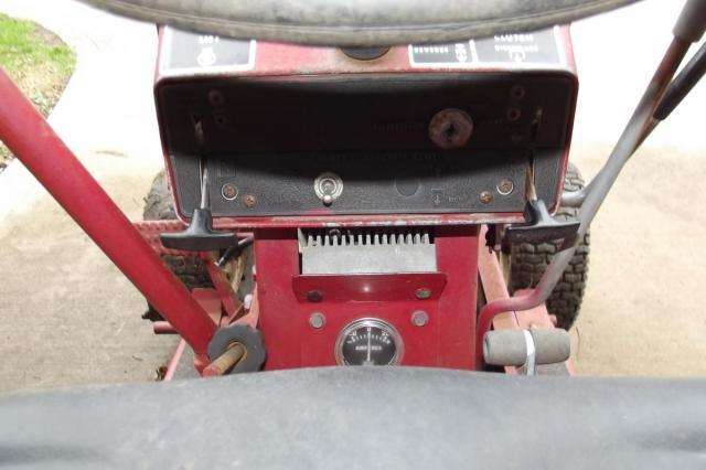

BOWTIE 226 #16 Posted April 14, 2015 THE OLD TRACTOR IS RUNNING NOW. CLEANED THE FUEL SYSTEM OUT PUT THE OLD FUEL PUMP BACK ON AND IT RUNS GREAT. THE CHARGING SYSTEM DIDN'T WORK. THE PROBLEM WAS THE WRONG IGNITION SWITCH. SOMEBODY PUT ONE IN IT FOR A MAGNETO IGNITION INSTEAD OF BATTERY/COIL/POINTS IGITION. NOW IT CHARGES AND LIGHTS WORK. I WISH THEY PUT PART NUMBERS ON THOSE SWITCHES,THEY WERE BOTH 5 TERMINAL. CHANGED MOTOR OIL AND PUT 1 QUART IN THE AUTOMATIC AND SEEMS TO WORK GREAT. I WILL MOUNT THE SEAT AND TAKE FOR A SPIN SOON. 1 Share this post Link to post Share on other sites
