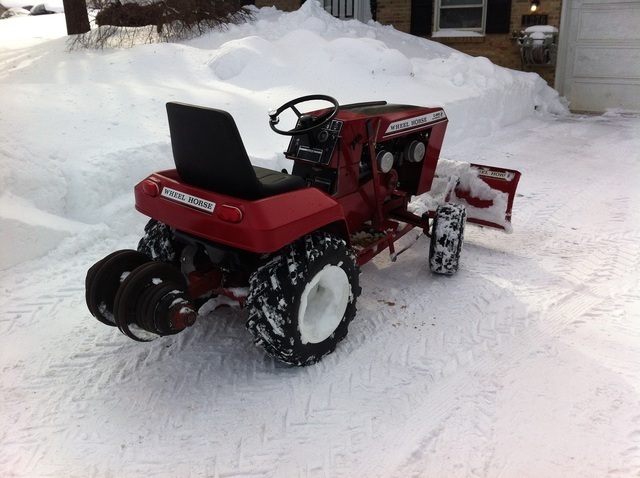

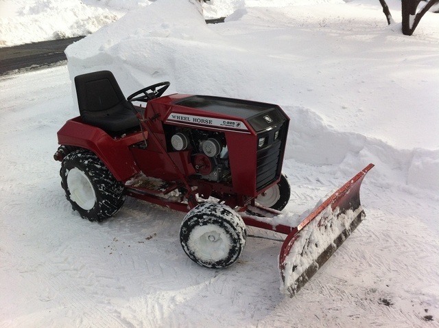

GT14 243 #72 Posted January 25, 2016 Had the C-225 our for some plowing, started right up at 10 deg. F and ran smooth. Wanted to plow without chains and the new tires worked great. That's 200# of weight on the back. 6 Share this post Link to post Share on other sites
