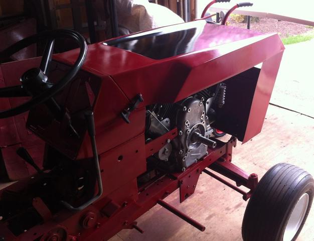

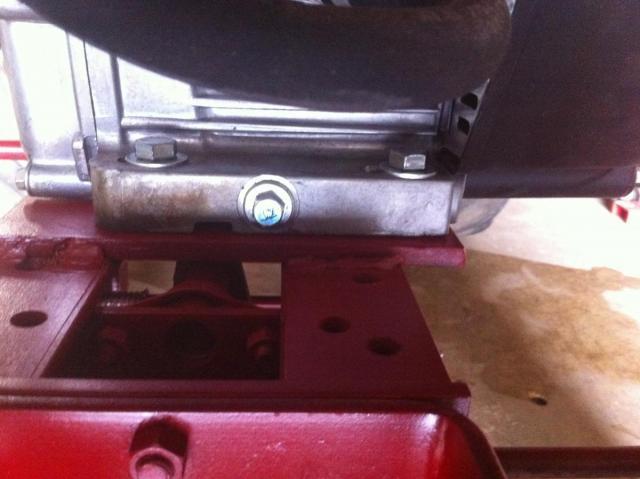

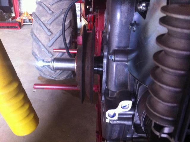

GT14 243 #26 Posted May 1, 2015 Getting back to work on the project. Went with solid mounts for now, offset is about 1.5 inch. the engine shaft has a step down which doesn't allow drive to be close to the engine case. Also added new rims and rubber 2 Share this post Link to post Share on other sites

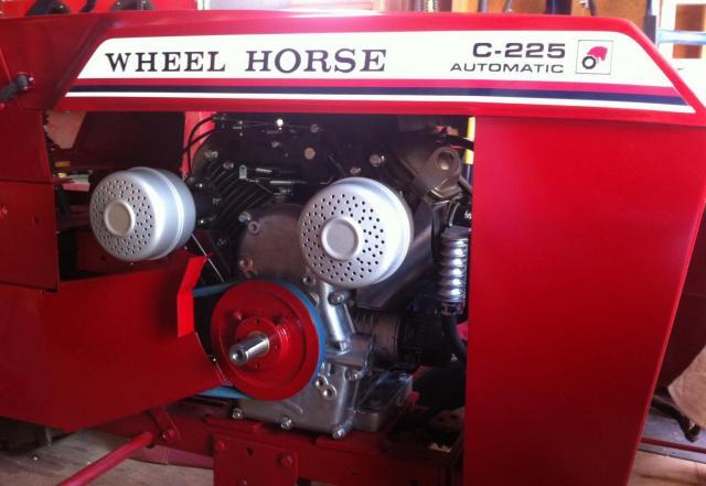

GT14 243 #31 Posted May 6, 2015 The new Models are out! 9 Share this post Link to post Share on other sites
chex313 123 #32 Posted May 6, 2015 (edited) I would like to place my order! Need a couple covers for the Mufflers... Edited May 6, 2015 by chex313 Share this post Link to post Share on other sites
shallowwatersailor 3,221 #33 Posted May 7, 2015 The new Models are out! IMG_1483.JPG Are the Pepper Pots going to provide enough backpressure? I like the new decals! Share this post Link to post Share on other sites

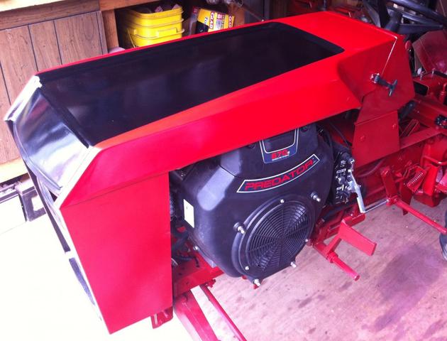

Theroundhousernr 590 #34 Posted May 7, 2015 If the motor would have been at the proper height for the belt guard, I take it the motor wouldn't have fit? That thing must be a beast of a thing not to fit under a black hood! Share this post Link to post Share on other sites
Pullstart 71,005 #35 Posted May 7, 2015 yeah that'll sound good n mean! Share this post Link to post Share on other sites

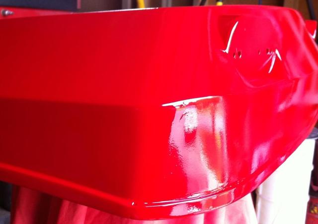

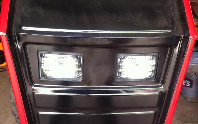

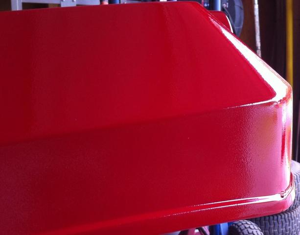

GT14 243 #36 Posted May 18, 2015 All mechanical work is done, I am repairiing the plastic fender now.Have the key installed in dash and used original choke and throttle cables.New Headlights installed.Broken fender will be repaired with a piece of 1/8 ABS, sheet metal and JB Weld. 4 Share this post Link to post Share on other sites
bmsgaffer 2,071 #38 Posted May 26, 2015 Nice! Now put that fender up on a shelf so it doesn't break again! 2 Share this post Link to post Share on other sites
GT14 243 #39 Posted May 27, 2015 (edited) Nice! Now put that fender up on a shelf so it doesn't break again! Tractor would look odd without a seat pan. Would love to find a nice metal replacement, the plastic is not my style. Edited May 27, 2015 by GT14 1 Share this post Link to post Share on other sites
Catmanii 36 #40 Posted May 27, 2015 I have had to repair mine also, just a long crack. I used fiberglass on the inside and smoothed it back up and painted the pan. The plastic pans are a real pain to get gas in the tank since it's so far down to the cap. I also would like a metal pan, but so far stayed with the plastic since that's what come on it. 1 Share this post Link to post Share on other sites

GT14 243 #46 Posted May 29, 2015 I have had to repair mine also, just a long crack. I used fiberglass on the inside and smoothed it back up and painted the pan. The plastic pans are a real pain to get gas in the tank since it's so far down to the cap. I also would like a metal pan, but so far stayed with the plastic since that's what come on it. Mine was a real mess, long crack down the middle (front and back), small cracks on both side and the big chug missing. I took about 8 hrs. to do all the repairs and paint. Share this post Link to post Share on other sites

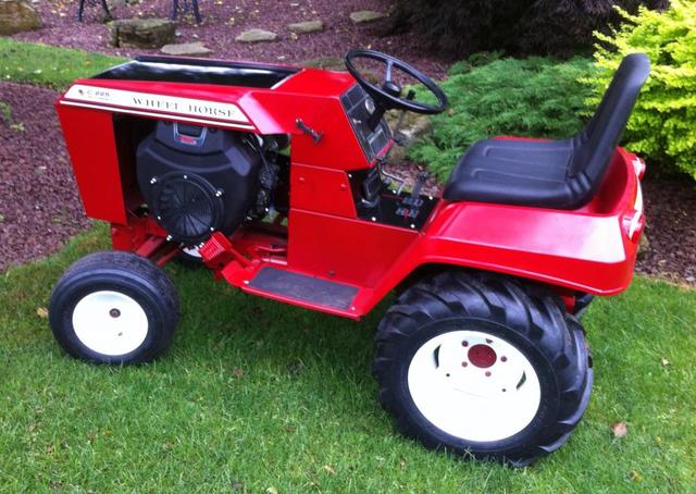

GT14 243 #49 Posted June 3, 2015 Ok the big day has come, out for some pics. 13 Share this post Link to post Share on other sites
bmsgaffer 2,071 #50 Posted June 3, 2015 Cool! Can we get a start up and running video?That thing looks loud with the pepper pots on there! Share this post Link to post Share on other sites
