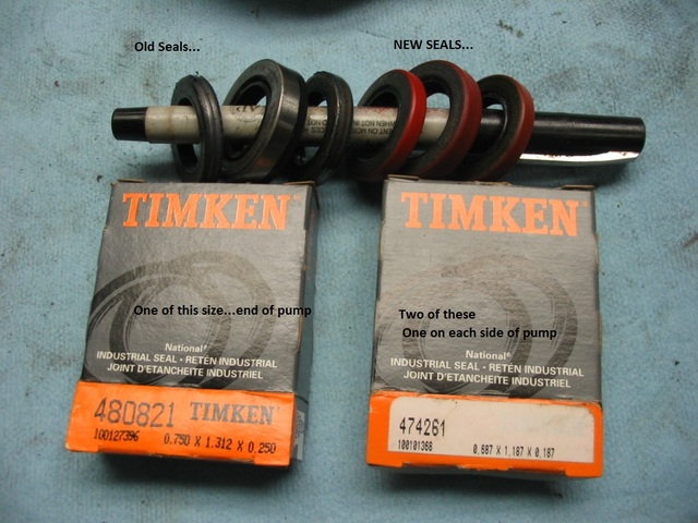

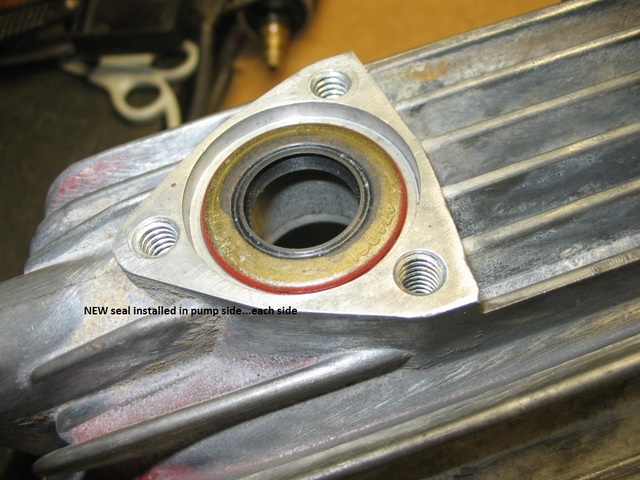

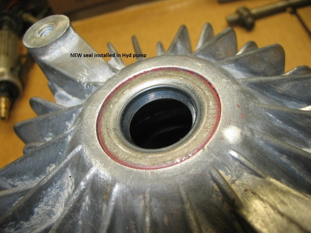

daveoman1966 3,882 #3 Posted March 31, 2015 I used TIMKEN seals... shown here. The seal dim are on the box. 1 Share this post Link to post Share on other sites
