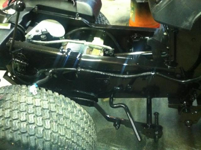

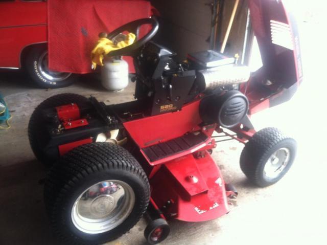

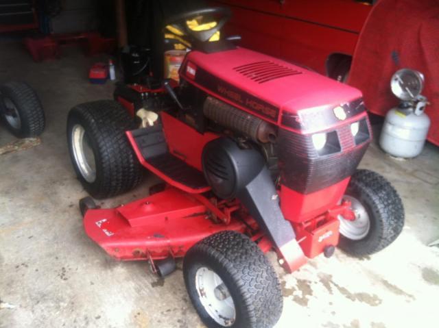

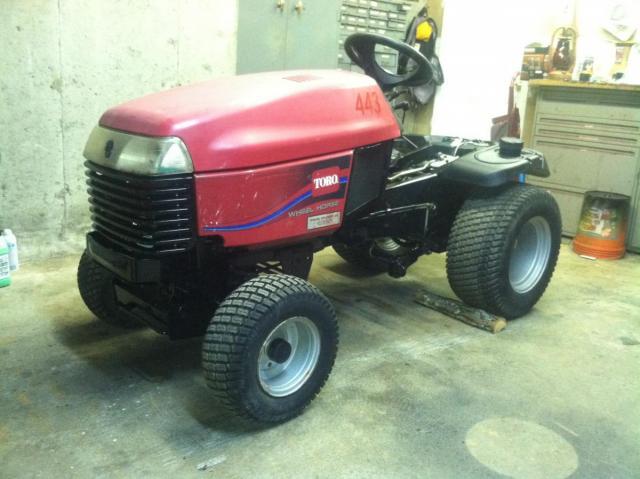

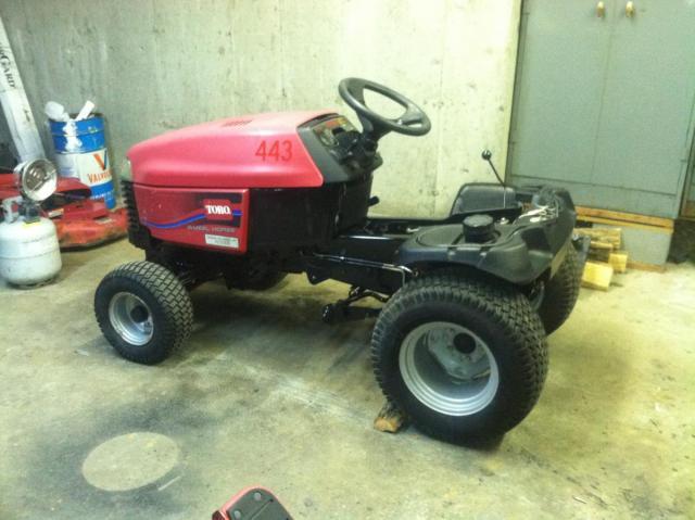

stevebo-(Moderator) 8,742 #26 Posted April 1, 2015 Tonight I was able to get the chassis, screens and front grill painted. Bought a new battery and battery cables too. Here are a few pics as it sits tonight. I also had some time after work to pressure wash one of the 520's that I picked up last fall. 2 Share this post Link to post Share on other sites

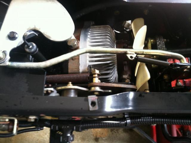

stevebo-(Moderator) 8,742 #38 Posted April 2, 2015 Here is a pic of the pump with the driveshaft. Share this post Link to post Share on other sites
