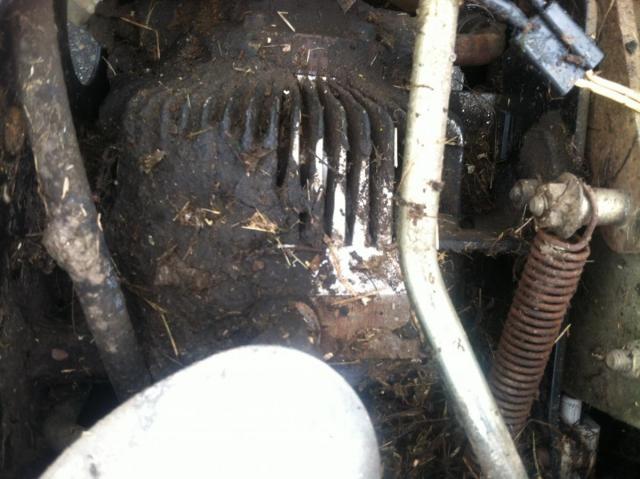

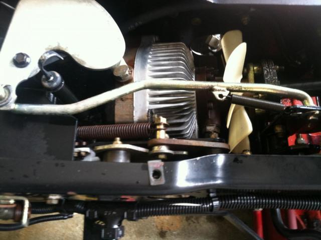

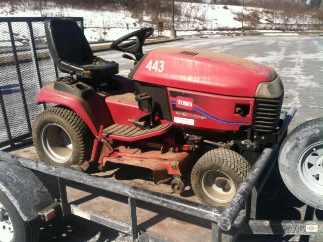

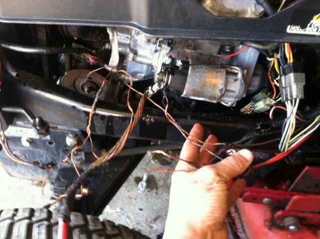

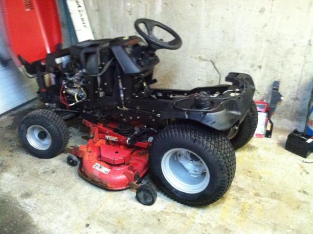

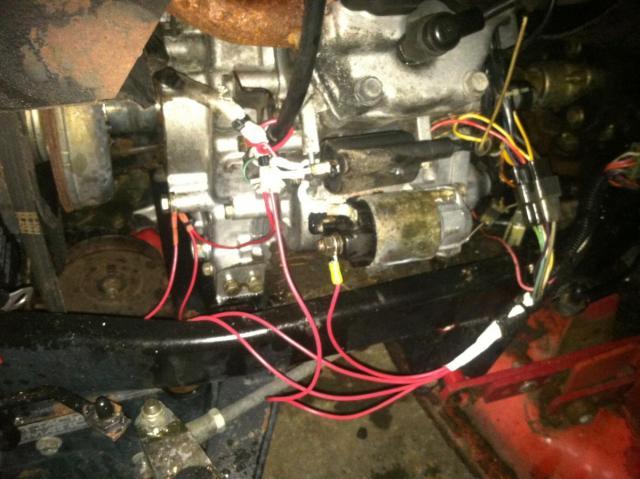

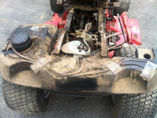

stevebo-(Moderator) 8,742 #1 Posted March 30, 2015 I posted in the thread - what's in your mirror about this tractor. I figured since I am going to be doing some work on it I may as well start a thread on it. This tractor was purchased from Baerpath this past weekend. He bought it was and never got around to doing anything with it. The lower wiring harness caught fire and the PO shut it off and put the fire out. He then sold it and I ended up with it. I have been looking for an xi series tractor for a while but the current owners had them all priced at what they should be (too much for me). Knowing this one needed work Baerpath gave me a good deal on it. I already replaced the burnt wiring with Fireman's help yesterday and I did a nice job soldering all the connections. Jeff looked up the parts that were needed and I ordered them. They will hopefully be here by the end of the week. I had some free time today so I started to pull the sheet metal off to take a look at what the underside looked like and get it cleaned up. Well here is what I found... After a lot of cleaning with the pressure washer I was able to get it nice and clean. I plan on touching up some areas on the frame to stop any rust and while the tins are off I may just have to sand them down and paint them. I think I will really like using this one so it will by no means be a show piece rather a nice clean worker. I was told the decals are NLA so I guess Terry may have to draw these up.... 10 Share this post Link to post Share on other sites
PaulC 342 #2 Posted March 30, 2015 that cleaned up awesome!! amazing what a good pressure washing once in a while can do. When I did this to my 1990 312 I thought to myself "some of these pieces of crud could be 15+ years old" haha Share this post Link to post Share on other sites

lodestonefarm 41 #5 Posted March 30, 2015 That really did clean up nicely. Is there any worry that the pressure washer, blasting away at everything, will force water where it shouldn't be, or cause new harm? I have yet to pressure wash my machine but it would certainly beat all that elbow grease and there are places my elbows just don't fit. Share this post Link to post Share on other sites
Theroundhousernr 590 #6 Posted March 30, 2015 That did clean up great! One day , I may have to get one of those nice machines. As far as pressure washing. I just make sure to change oil and filters afterwards. Keep in mind to stay away from electronics , open holes like breathers, gas cap , carb and it should be just fine! Share this post Link to post Share on other sites
shallowwatersailor 3,221 #7 Posted March 30, 2015 That really did clean up nicely. Is there any worry that the pressure washer, blasting away at everything, will force water where it shouldn't be, or cause new harm? I have yet to pressure wash my machine but it would certainly beat all that elbow grease and there are places my elbows just don't fit. I pressure wash mine when I get them. But you do need to be careful and use the lowest pressure tip first. Obviously keep it from the electrical components. I think some of the cleaners can do more harm, especially to the paint. Share this post Link to post Share on other sites

stevebo-(Moderator) 8,742 #9 Posted March 30, 2015 I agree. When using the harsh chemicals you need to know not to put it on paint as it could stain. Usually I hit with pressure washer first then use a degreaser like simple green or purple power etc. I did that to get it ready for paintwork. Nothing is worse then starting off sanding oil or grease. The tins need to be really clean before you start to sand them down. Craig- Great to see that Terry is producing them !! They are the upgraded version imo. Share this post Link to post Share on other sites
