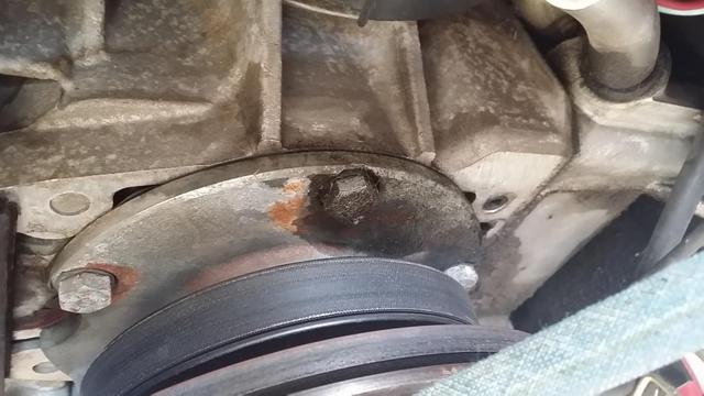

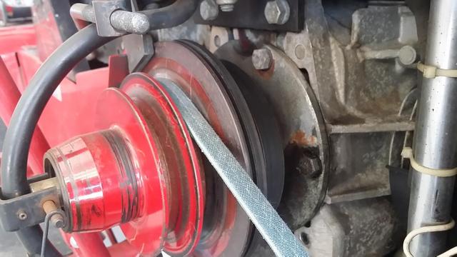

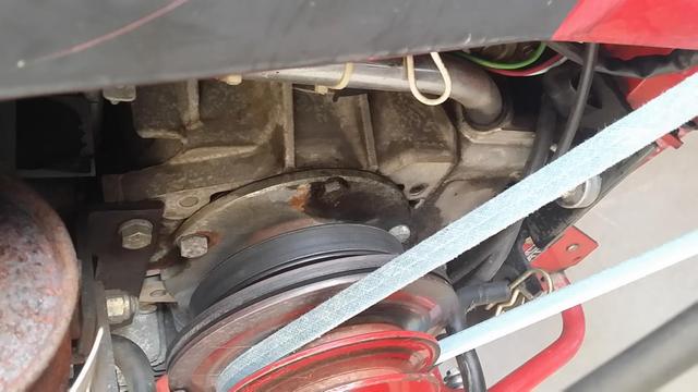

gabe911 23 #1 Posted March 28, 2015 Started to take off the blower and putting the deck back on and just noticed the below pics. Thank you for any input. Share this post Link to post Share on other sites
gabe911 23 #2 Posted March 28, 2015 Just noticed the above pics were upside down. Here's one the right way. I just never noticed any oil like that leaking before. Share this post Link to post Share on other sites
boomers_influence 106 #3 Posted March 28, 2015 gabe the five bolts that attach the rear brg. plate, SHOULD have thread sealer on them. torque to 25-27 ft lbs. thank you. boomer ( the used onan engine parts guy, also NOS and new ) Share this post Link to post Share on other sites
