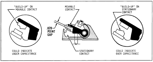

rmaynard 16,404 #3 Posted March 28, 2015 If you have build-up on the points, it is usually from a bad condenser. Here is a drawing from the Kohler manual. 1 Share this post Link to post Share on other sites
