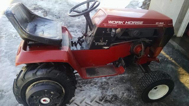

PM83GT1642 2 #1 Posted March 24, 2015 Hi All, New to Wheel Horse so I'm a bit green. Bought an '83 Work Horse GT 1642 (Original B&S), really like it and plan on refurbishing soon (bought decals already). Recently started having issues with the ignition switch as it intermittently won't shut down after starting. Disconnected, shined/tightened the male/female spades and worked well for a bit but became sporadic again. Anyone know what type of ignition switch it takes. Not near it at the moment or I wouldn't bug you. Thanks for your insight. Oh! The one that's in it has a 5 spade connector and ground if that helps. Share this post Link to post Share on other sites
