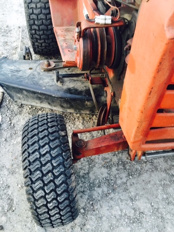

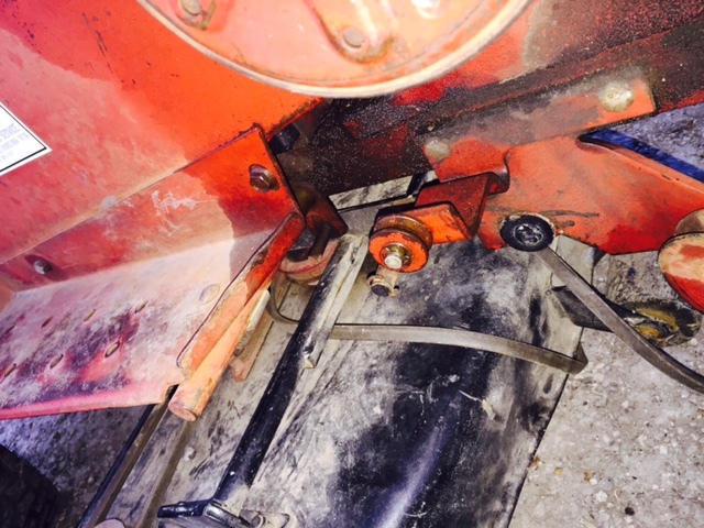

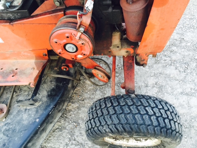

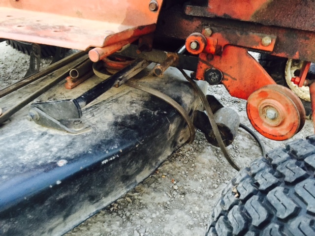

What all is missing from the pictures that i need to direct a belt/s from the pto clutch to the deck?ive had my horse about a year but never had a deck on it because the deck i got with it was trashed but i finally found a deck for her and all i need to know what parts are missing.Does anybody have pics of what it should look like?Thanks

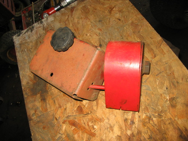

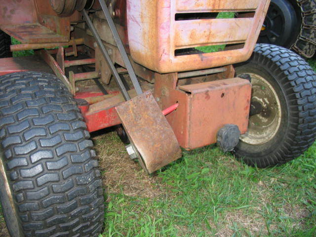

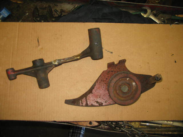

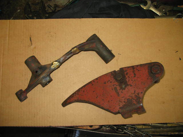

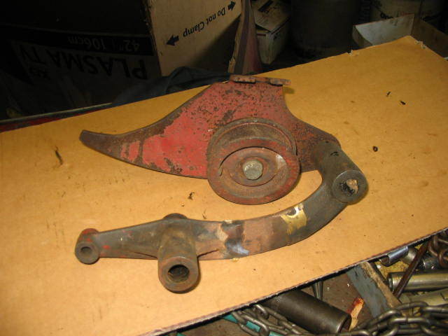

I can see that you have a 42" deck and here are the missing parts for the belt hook-up (1st 2 pics). This is the old style side-adjust mechanism and is very prone to breakage, as in the pics. Not only is this a cumbersome set-up, it is also sloppy and not very easy to adjust and set the belt tension.

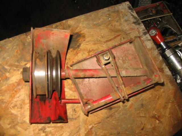

I can also see that your tractor has the front Tach-o-Matic hitch that makes the deck hook-up TONS easier. What you really need to do is get the FRONT MULE DRIVE that locks into that hitch. Using this setup, the belt is routed out around the front axle, then back to the deck. Very easy to adjust the belt...just turn the front knob. Very easy to remove too, using a push-button release mechanism.
I don't have the old parts, but I do have the front MULE DRIVE.
