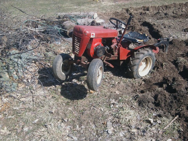

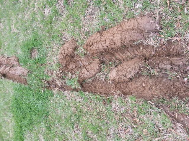

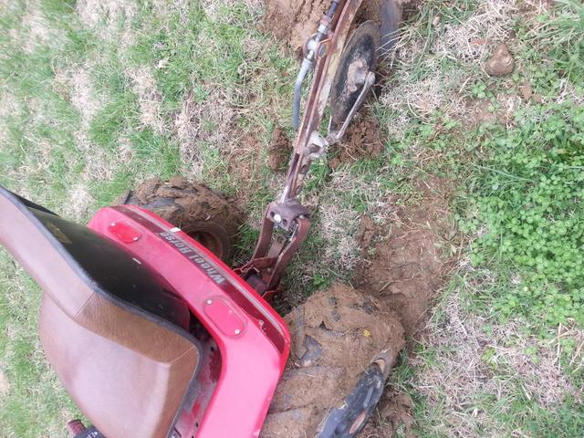

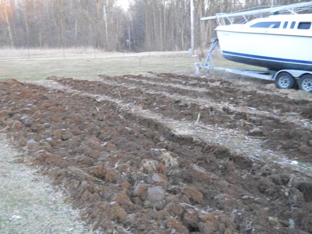

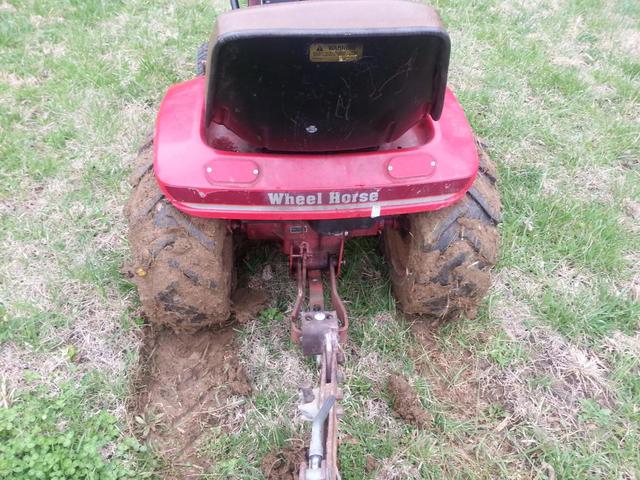

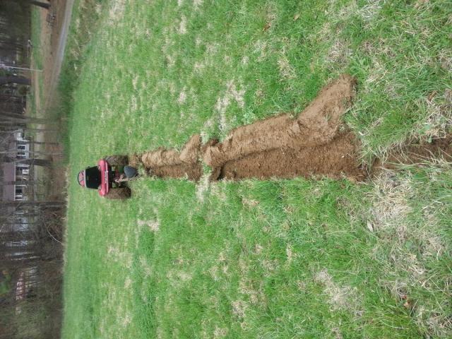

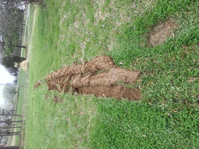

ibskot 37 #1 Posted March 22, 2015 Well, maybe not a complete disaster, nobody got hurt and my son had fun. I quickly realized I have no clue what I am doing and I think it's too wet. Plus I think my tractor is too light. Anyway, here are some pictures. I tried to upload a video but I don't have permission for some reason. Any guidance is appreciated. Plus I clearly don't know how to properly rotate pictures. Share this post Link to post Share on other sites

Sparky-(Admin) 24,658 #3 Posted March 22, 2015 If your making a long single row garden you nailed it!! Just kidding....I've never owned or operated a plow like that, but the guys on this site will get ya straightened out! Mike.......... 1 Share this post Link to post Share on other sites
C-101plowerpower 1,606 #4 Posted March 22, 2015 (edited) this might help a bit http://myoldmachine.com/topic/1616-ploughing-and-ploughs-2015/ also once you've made one furrow, go back taking half plow width, then plow the things you just plowed out back in full plow width, then start going round also make sure you've got the plow nice and shiny where it meets the ground, a rusty or painted plow shear is a bear to drag through the ground hope that's clear enough Edited March 22, 2015 by C-101plowerpower Share this post Link to post Share on other sites
squonk 45,589 #5 Posted March 22, 2015 There's a lot of trial and error and sod is hard to plow anyway. Plus it does look a bit wet by what's sticking to your tires. I would just plow what you were planning on and just tinker with it. Your not entering a contest. After that ground is plowed up I would till it up and you'll be fine. Plow it again in the fall and I bet it will go much easier. Here is a short video of my first time plowing. My wife's garden is small which made it more difficult. Share this post Link to post Share on other sites

KC9KAS 4,746 #7 Posted March 23, 2015 (edited) ibskot, you need to weight the tires/rear of the tractor if you haven't done so. I have turf tires with tire chains and fluid in the tires. I have plowed with a 10" plow using a B-80 and it worked very well. The ground may be a little to wet, but I think your biggest issue is with weight (actually, lack of...) Edited March 23, 2015 by KC9KAS Share this post Link to post Share on other sites
slammer302 2,157 #8 Posted March 23, 2015 I use a commando 8 for plowing most of the time i use weights front and rear and it is still hard to plow up a garden if hasn't ever been plowed in the past years but if its been plowed before its no problem so what im saying it should nice and easy next year. Share this post Link to post Share on other sites
clip 185 #9 Posted March 23, 2015 (edited) Remember to keep making passes in the same direction. If you plowed south to north your first pass with the dirt rolling to the east, keep making passes from south to north moving east to west, so your right tires are always in the furrow. For every trip up and back, you'll only be plowing once. If you do want to plow both coming and going, start on the outsides and work in, but it will leave a dead furrow in the center. Edited March 23, 2015 by clip Share this post Link to post Share on other sites
farmer 1,081 #10 Posted March 23, 2015 looks to me like a good first attempt, pointers I would offer would be, Plough only when ground conditions are right ( to wet, or hard and dry will damage the soil and frustrate the £#@k out of you.) You have narrow agri weighted rears, ideal. Maybe you could reduce the furrow width by mounting the plough in the left hand hole of the three? And (I know its a pain) clear out the furrow if the slice has rolled back, every time the right wheels climb over a lump the plough is pitched... and the same thing happens again, get an open furrow and it should stay open. Hope this helps and have fun in the dirt. 2 Share this post Link to post Share on other sites
doc724 925 #11 Posted March 23, 2015 Just about all the replies have nailed it, but no one told you how to tell if the ground is too wet to plow. I was always told, pick up a handful of soil and squeeze it in your hand, if it makes a meatball that will not fall apart, it is probably too wet. If it falls apart, it is just right for plowing. The problem with plowing wet soil is that you compact it and all the air is squeezed out of the soil under the tractor. The water then does not drain well and the plant roots cannot breathe. 3 Share this post Link to post Share on other sites
prondzy 3,889 #12 Posted March 23, 2015 Looks like you tried for a second pass? If I'm seeing the pic right your left side is in the furrow. It should be the right side tires in the furrow otherwise your fighting the plow with the tractor. Share this post Link to post Share on other sites

ibskot 37 #14 Posted March 24, 2015 Thanks for all the feedback.i did in fact try a second and third pass. My son loved it. Gonna take some advice too and add liquid to rears this weekend. I may buy some chains too. Not sure. I really think if I can get heavier and it dried a bit I can do it. The other thing is getting the plow properly set....and gonna take the suggestion from another thread to drill my hitch to give more lift so I don't drag through the yard and driveway getting to plow spot. Thanks Share this post Link to post Share on other sites
ericj 1,579 #15 Posted March 24, 2015 i shorten my chain length when transporting and lengthen when i plow. it will barely lift when you are plowing, but you can get the job done. and if you plow with the ground to wet that plow will pull harder then 5 tons of bricks lol eric j Share this post Link to post Share on other sites
doc724 925 #16 Posted March 24, 2015 You do not have to have the plow set super deep. I used to set mine so that it would go down 6 inches. To keep from digging up the lawn before you get to the garden area, crank the plow point all the way up (turn the lever on the plow to the right) and when you get to the garden reset it. I found I needed to pull the lift lever up while making turns to prevent gouging of the lawn before the return pass. I always had a few clumps I had to stamp back down on the lawn. I don't use a plow anymore. I now use a tiller. The reason is that it is too difficult to break the clods up with a disc harrow-they are just too light in weight-especially for newly broken soil. As someone else said, it is fun though. PS: be careful when you are plowing, snag a root or big rock and the front end will come come off the ground really fast! Share this post Link to post Share on other sites
