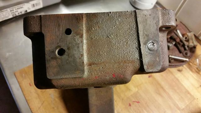

kolvari 4 #33 Posted May 25, 2015 Been awhile, got the case from Lars a week ago, plus the differential "body" part too, a piece was chipped there too.Should not take long to ride again. Hardest part is to get out a broken bolt from that case.Any advise? I guess the case needs to be tightened with that bolt too, can't do any good to leave it without?So anxious to get it together that wouldn't wanna spend hours on it.Is there drillbits that will do it, or just to take it to a shop.There is no way of welding anything to it.Tom Share this post Link to post Share on other sites
kolvari 4 #34 Posted June 11, 2015 Had to take it to a shop where they had this "$10000" drill. They charged 50 which seemed high, although said that they had struggled too for a long time.I tried welding a nut and all kinds of HSS drill bits, no go, not even near, it had hardened so much.Well now it's just putting it back together.Tom Share this post Link to post Share on other sites
gwest_ca-(File Mod) 11,848 #35 Posted June 11, 2015 Wonder if that bolt was too long and bottomed out in the threads? Odd that the head break off and still be too tight to easily remove.Garry Share this post Link to post Share on other sites

kolvari 4 #38 Posted June 26, 2015 (edited) Yee-haw! Got it back together and on and shifts like it should. Went smoothly, only trick was the oil seals because the axles wouldn't center in the housing. There was roughly 1mm clearance on the other side and 3,5-4mm on the other. Very hard to squeeze them in without breaking the seal. Had not the correct size pvc-pipe so I just used whatever tools and pipes I had. But seemed like the the pvc-pipe would be the way to go.Put 10/30 engine oil in an drove 15min without leaks. Still to change the the oil to thinner one.So all good, and very grateful to You guys!What a great big family we have here.Stevesaurus have you visited Finland already?And Lars and I could meet in Lapland to catch some salmon..Tom Edited June 26, 2015 by kolvari 2 Share this post Link to post Share on other sites
