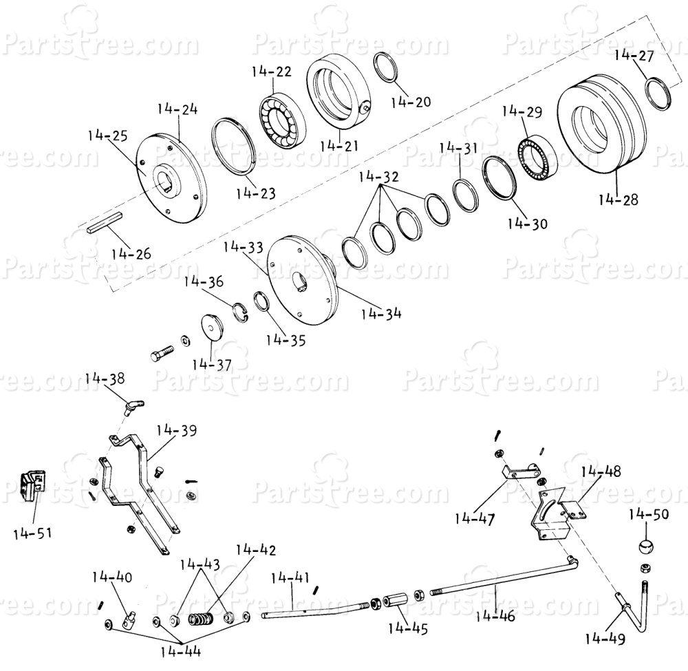

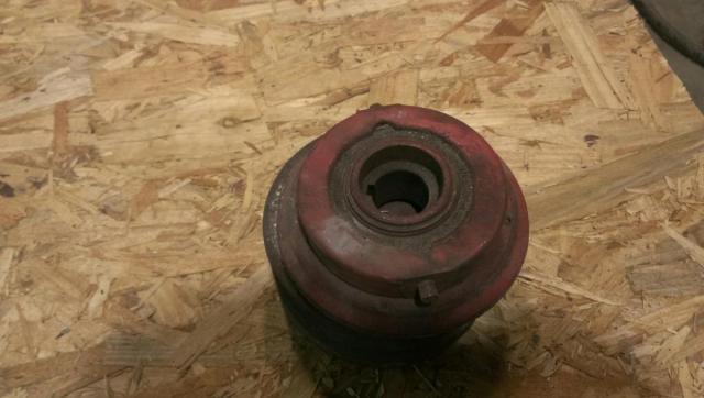

duke 49 #1 Posted March 20, 2015 I have had three PTO assemblies and ruined two of them already! The diagram shows a specific sequence of parts and the One I just received looks to be partially backwards with respect to parts, 102911 collar,102918 ring internal and finally 102917 ring external. I don't imagine there is much difference which way the collar faces but is it critical to be identical to the diagram? The part 102905 clutch plate appears to be pressed through the part 102914 bearing and then held with the part 102917 ring external? I really need help to get this right and all the service manuals do not show this vital aspect of the assembly at all, which is quite strange if you ask me! In the photo of the replacement PTO you can clearly see the part 102918 ring internal on the back side of the collar, which is wrong according to the diagram, but is it critical and should it be corrected? Any help would be greatly appreciated! Share this post Link to post Share on other sites

duke 49 #3 Posted March 20, 2015 No, there is no mention of the sequence in the manual but I found a video of another PTO torn apart and the collar was as pictured in the diagram. I mean it wouldn't be much to press it out, if I knew exactly what part is supposed to be pressed out! I imagine the bearings would of been replaced at one time or another, so where is that service manual to be found, if one exist at all? Ha,ha,ha! Thanks for the suggestion, I have the same manual already. Share this post Link to post Share on other sites

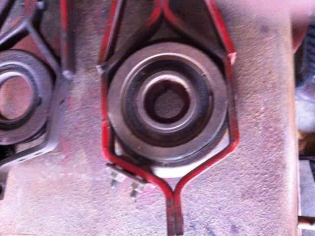

duke 49 #5 Posted March 20, 2015 So if I press out the back clutch plate and in turn reverse the collar, the bearing could end up backwards? The PO had put this together in this manner for a reason, perhaps to make removal of the bearing easier in the future? The snap ring should hold the pressure and is as strong as the casting on the collar, makes me wonder and I really don't want to try an press out anything if it isn't necessary! I did notice the internal ring on the double pulley was out of the grove, which might explain why there was some rubbing going on the clutch bar . I was going to bring the clutch bar to work and sand them flat again, remove the "groves", however, I wonder about weakening the bars? I had a long wait finding yet another clutch, so I really don't want to mess it up! Share this post Link to post Share on other sites

duke 49 #7 Posted March 20, 2015 (edited) The retaining rings used on the clutch are the type that wind around the grove, not a C clip or typical two hole ring. I'm not sure yet on the load side of the bearings, not it's identity. I will find out though. Thanks. Yes, I already found out the hard way about the load side of these expensive bearings! I found this which is the correct assembly. Now if I bought the other one from a Mechanical Engineer, wouldn't you "think", that he knew it was backwards? Edited March 20, 2015 by duke Share this post Link to post Share on other sites
