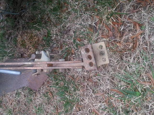

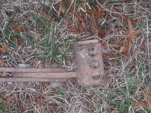

ibskot 37 #1 Posted March 19, 2015 Picked up this plow today in preparation for Saturday. This hitch mount is bent a bit. Can I still use it? Should I? I won't have a chance to try and fix it before Saturday and I really want to plow. Any thoughts are appreciated. Share this post Link to post Share on other sites

squonk 45,591 #4 Posted March 19, 2015 The plow mount is supposed to be off set but that is bent. It won't track right. Share this post Link to post Share on other sites
oldredrider 2,553 #5 Posted March 20, 2015 Some heat from an acetylene torch and a vice can straighten that out and you're back in business. Share this post Link to post Share on other sites
ibskot 37 #6 Posted March 20, 2015 Thanks a lot. I am gonna phone a friend if I get back from ATL tomorrow. Thanks Share this post Link to post Share on other sites
squonk 45,591 #7 Posted March 20, 2015 The part with the three holes is supposed to have a twist in it so when the tractor is in the furrow the plow is level. Share this post Link to post Share on other sites
oldredrider 2,553 #8 Posted March 20, 2015 If you look closely at the top and bottom photo, the twist is there. It only needs to be straightened lengthwise. Share this post Link to post Share on other sites
new2horses 287 #9 Posted March 20, 2015 As oldredrider says the twist should be there bend no. It needs to be straightened. Share this post Link to post Share on other sites
Ed Kennell 45,021 #10 Posted March 20, 2015 Some of the bend could be compensated for by uneven tightening of the 1/2" anti sway bolts in the hitch. But this bend is too much and should be straightened. The twist in the plow tongue is to compensate for the tractor not being level when the right wheels are riding in the open furrow. Share this post Link to post Share on other sites

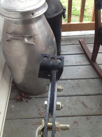

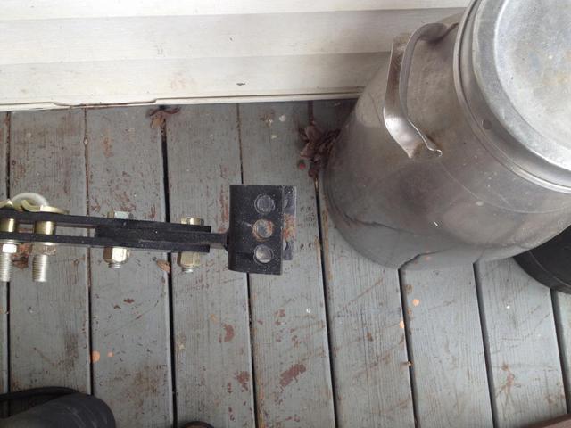

ibskot 37 #11 Posted March 20, 2015 Is anybody able to post a pic of theirs? I can't get a food straight pic off Google. Thanks Share this post Link to post Share on other sites
Bert 775 #12 Posted March 20, 2015 This might help 1 Share this post Link to post Share on other sites
ibskot 37 #14 Posted March 21, 2015 "food" straight? Meant good straight. Dang small keys on phone. Thanks folks for the pics. I have an appointment with a friend with a torch tomorrow. Hopefully I will be posting pics sunday of my newly plowed garden. 1 Share this post Link to post Share on other sites
