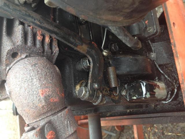

boovuc 1,090 #11 Posted March 20, 2015 Wheelhorse66, Could you please get a picture loaded here of your governor arm to the carburetor? Again, many things can affect and cause this issue. I had written before about a loose throttle valve but I also see you just now changed the condenser. It does indicate a lean mixture but did you also: 1. Clean the gas tank making sure the screen at the shut off valve isn't filled with rust/gunk? 2. New points? 3. New fuel line? 4. New fuel filter? 5. Run it with the gas tank cap off at full throttle? 6. Check for good fuel pump volume? 7. New plug? 8. New plug wire? See what I mean by various things that can and will effect performance at full throttle let alone idle. Hang in there. You'll figure it out! Of what I mentioned above, clean out the fuel tank making sure the screen, (if it is still there), isn't clogged then change the fuel lines if you didn't do so already with a new fuel filter. Make sure the filter is installed correctly with the arrow showing the proper direction of fuel flow. After you change the fuel lines and filter, check to make sure you have a good "pulse" of fuel shooting from the fuel pump. If it is dribbling out instead of "shooting" out while the engine is running, this is a concern and will cause a lean fuel delivery to the engine resulting in backfires, unattainable top RPM and overall poor performance. 1 Share this post Link to post Share on other sites
wheelhorse66 10 #12 Posted March 20, 2015 (edited) Here is the pic of the governer arm Edited March 20, 2015 by wheelhorse66 Share this post Link to post Share on other sites

boovuc 1,090 #15 Posted March 22, 2015 As long as the gov is hooked up and when idling to full throttle, you see it acting as the RPM's change. I have seen too many K-series where the PO simply bypassed it. How about item for item in my prior post did you do or check? Share this post Link to post Share on other sites
