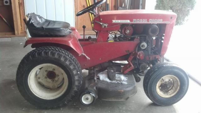

sdhdcouple 133 #1 Posted March 18, 2015 Well I have always liked the looks of the old Wheel Horse tractors, just have no knowledge of them and make my choice to buy on looks. So here is the tractor I am making the 4 hour trip to add to my tractor collection. I am not sure a lot about it due to lack of knowledge of Wheel Horse. Maybe you guys can help with info on her. Here is what I know about it: (info is from current owner) he is 2nd owner and bought it from 1st owner back in 1974 it has mower deck, front plow and snow blower he says it is a 1257 six speed and he sent the following pictures. any help on this tractor would be great and thanks 3 Share this post Link to post Share on other sites

sdhdcouple 133 #5 Posted March 18, 2015 well I guess I am wanting to know if the info I was giving is correct. Can you guys tell what model it is by the pictures? and also is the six speed a common item on a Wheel Horse? and I guess last what do you guys think it is worth with all three attachments. He says it runs and he mowed with it until the year before last. He is an old gentlemen and it was just getting to hard for him to operate so he bought a new tractor. I just don't want to go blind to close the deal I guess. Share this post Link to post Share on other sites
squonk 45,816 #6 Posted March 18, 2015 67 is the first year for the hi/lo trannys. A 1257 should be a 4 spd and a 1267 has the Hi/ lo. Either it's a 1267 or someone swapped a trans. Look on the hood /steering stand for an id plate Share this post Link to post Share on other sites
Ken B 3,203 #7 Posted March 18, 2015 If it were me I'd clean that one up real well and leave it. it looks to be in super shape. How much is he asking? 2 Share this post Link to post Share on other sites
Kelly 1,038 #8 Posted March 18, 2015 Looks like it will clean up nice, seat has been replaced but is a newer WH seat, yes it's a 6 speed I see both shifter, blower is for a newer tractor will not fit that one unless he has a front mount to adapt it, and I don't see one in pic, but ask if he has one. Share this post Link to post Share on other sites
sdhdcouple 133 #9 Posted March 18, 2015 he said he the blower came with the tractor when he bought it, but he has never used it. but he got the blower in 74 from the other owner. he has used the plow and the mower, so he knows they work with the tractor. I will ask about the adapter plate. does anyone have a picture of one so I know what to look for? I plan on just cleaning it and leaving it as a non restore survivor tractor. I get everything for $500 I think it a good offer, but I come with that from Allis chalmers / Simplicity or cub cadet buying. 1 Share this post Link to post Share on other sites
Racinbob 12,851 #10 Posted March 18, 2015 That's a good buy. I do think it's a 1267 with the 6 speed but the model number on the tag will confirm it. Kelly knows better than I do but I'm thinking that blower will work. It bolts to the frame and doesn't use the attach-a-matic front mount. That mount wasn't available in 67 but it could be adapted to it. Is there a tag on the blower? Share this post Link to post Share on other sites

boovuc 1,090 #13 Posted March 19, 2015 If that seat with the Wheelhorse logo isn't ripped and if it can be cleaned up, that is worth 50 bucks alone or more if it is really nice after cleaning up. That will make a nice stractor and you get the implements right off the bat! Share this post Link to post Share on other sites
neil 2,415 #14 Posted March 19, 2015 She is a nice tractor , paintwork looks in excellent condition , good price, the dozer looks to be for a long frame tractor but will still fit your tractor,make sure you pick up the dozer blade handle & the bracket that goes on the trans axle so that the blade can be attached , it may already be on the tractor. One other thing, you will now be looking for another tractor to keep her company , if you are not looking yet you soon will be. Have fun with your new horse, you're gonna love it 1 Share this post Link to post Share on other sites
Ed Kennell 45,325 #15 Posted March 19, 2015 Looks good. The blowers came with several attachment kits. If that is a bolt in the mounting bracket, it will bolt to the frame. If it is a welded bar you will need the front tach-a-matic[, or alter it to bolt to the frame. To use the blower, you will also need the two pieces to lift the blower. They are the red parts in the picture...the "FLAG' and the push pipe. The unpainted parts are for attaching lift assist springs. . Good luck and to Share this post Link to post Share on other sites
squonk 45,816 #16 Posted March 19, 2015 She is a nice tractor , paintwork looks in excellent condition , good price, the dozer looks to be for a long frame tractor but will still fit your tractor,make sure you pick up the dozer blade handle & the bracket that goes on the trans axle so that the blade can be attached , it may already be on the tractor. One other thing, you will now be looking for another tractor to keep her company , if you are not looking yet you soon will be. Have fun with your new horse, you're gonna love it On my 1267 I had to use a long frame plow. I have a shortie but it wouldn't work. With filled tires it's a plowin animal! Share this post Link to post Share on other sites
RedRanger 1,470 #17 Posted March 19, 2015 On my 1267 I had to use a long frame plow. I have a shortie but it wouldn't work. With filled tires it's a plowin animal! I thought the 10xx and 12xx were long frames? Am I wrong? They have longer hoods and longer wheelbase than the short framed tractors of that era. Share this post Link to post Share on other sites
RedRanger 1,470 #18 Posted March 19, 2015 (edited) 67 is the first year for the hi/lo trannys. A 1257 should be a 4 spd and a 1267 has the Hi/ lo. Either it's a 1267 or someone swapped a trans. Look on the hood /steering stand for an id plate That's a 1267 unless someone swapped both the trans and the hood decals. Great find, and good price. I'd try for $400-$450 with those attachments. You'll put another $400 into her quickly just fixing her up. belts, gaskets, filters, battery,bearings, tune up, etc.... Edited March 19, 2015 by RedRanger Share this post Link to post Share on other sites
