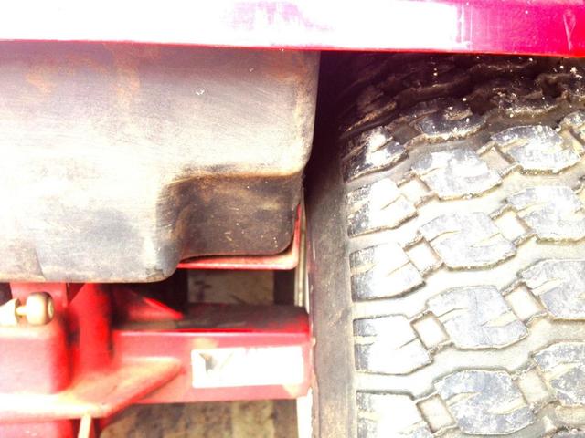

randym 3 #1 Posted March 15, 2015 Just picked up a 1992 520-H to take advantage of the hydraulic lift when using my two-stage snow thrower. My son's helping me work out a few mechanical issues; in meantime, I'm puzzled about putting chains on the rear tires. I've always used Wheel Horse 50 lb. weights and chains on my 312-8 with no problem. But as you can see on the attached photo (hope it attaches) there is only about 1/4" clearance between the inside of my rear tires and the gas tank supports. No way chains will clear that. The wheels as currently mounted appear to be flush with the end of the axle. (Hope I've got my terminology right.) Is this normal? Do you think there might be some spacers missing that would hold the wheels out further? Also, while you're being helpful, anyone know if the wheel weights I used on my 312-8 (with smaller wheels) will fit the wheels on my 520-H? What about the bolts; will they be long enough? (Tires on 520-H are 23 x 10.5 x 12. Tires on 312-8 are 22 x 9 x 12). Son is suggesting I put the smaller wheels and tires from the 312-8 on the 520-H, and put the larger wheels and tires from the 520-H on the 312. That way, don't have to worry about buying new chains, and perhaps buying new weights. I will be using the 312 for mowing, the 520-H for snowblowing. Thanks. Share this post Link to post Share on other sites

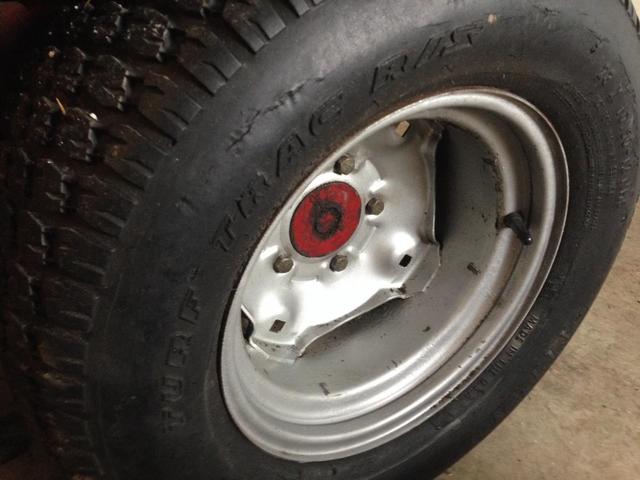

randym 3 #15 Posted March 15, 2015 Here's a photo of the wheel as mounted. It looks to be mounted proper direction to me; same as wheels on my other Wheel Horse tractors (312-8 and 312-A). Even though valve stem is facing out on this tire, unlike on my other tractors. Share this post Link to post Share on other sites
Eric C 109 #16 Posted March 15, 2015 They are definitely not WH wheels. The offset should be about 1 1/2 to 2 inches. Not sure. Here's a pic or 3 of my original wheels. Sent from my iPhone using Tapatalk Share this post Link to post Share on other sites
rmaynard 16,705 #17 Posted March 15, 2015 I have 7-1/2" rims on my 416-H. From the back of the rim at the center hole to the edge of the rim at the tire is 2". I think you have the wrong rims. Without the proper width from the outside of one rear tire to the other, you have a very unstable tractor. Share this post Link to post Share on other sites
randym 3 #18 Posted March 15, 2015 That has to be it, Eric. Thanks so much for taking the time to help. Share this post Link to post Share on other sites
