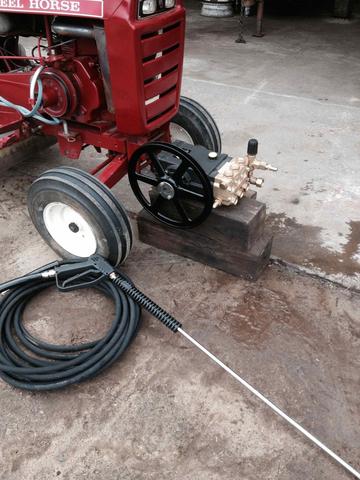

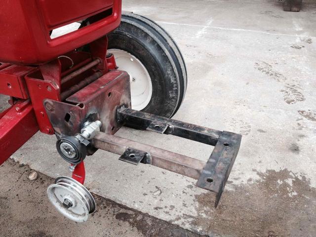

tbarnhart 240 #1 Posted March 15, 2015 I've always wanted a pressure washer and figured that the attachamatic on the front of the horse would make a great mounting point. I've been collecting parts for a few weeks and finally got a chance to put this together. Here is a shot of the mock-up with the pulley attached to the pump. The pump is 4.0 gpm at 4000 psi and the pulley size puts the engine rpms at 3000. I had an old mule drive that I had used the shaft and pulleys for another project. I added a few pieces of tubing and angle to mount the pump and a fancy "patented" tensioner. I removed the original tensioning screw and added a hook in the rear that locks the whole assembly rigidly to the attachamatic. It works. Now its all disassembled for some paint. It takes about 3 min to install and put on the belt. 18 Share this post Link to post Share on other sites

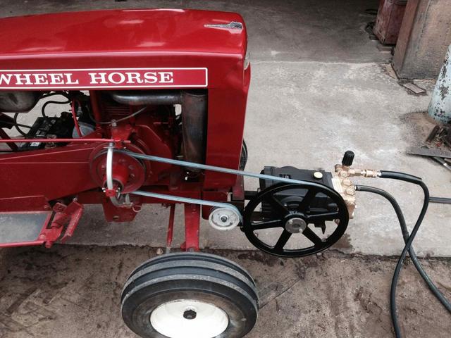

tbarnhart 240 #11 Posted March 19, 2015 ,as far as the water supply it would be far better if you charge the potable with at least 60 lbs air,a washer only amplifies what you give it,gravity fed doesn't work well with any that ive used I'm sure a pressurized water supply would be better, but General Pump states that this should work on a gravity fed supply as long as it gives sufficient volume. It takes a fairly large line to supply 4 gpm as gravity fed when you don't have a lot of vertical drop. As stated, these pumps don't have any suction to speak of and have to be fed. I got the frame painted and the pump installed. Now I just need to find time to put it to work-The siding on the house needs washed. Share this post Link to post Share on other sites
