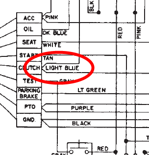

Save Old Iron 1,571 #29 Posted March 20, 2015 (edited) Is the plastic shell deformed or is this just dielectric grease on the plastic? A properly functioning indicator board draws about 1/2 to 3/4 of an amp max when all lights are on - much less if the indicator board is the newest LED version. If the connector appears melted, you may have a shorted indicator pcb, which may be shorting out your signals from the safety switches to ground. Try starting the tractor without the melted connector plugged in. Edited March 20, 2015 by Save Old Iron Share this post Link to post Share on other sites
aaubrey96 0 #30 Posted March 20, 2015 (edited) That did work. i patched that light blue wire into the other 2 and plugged that connector back in and it runs again. Edited March 20, 2015 by aaubrey96 Share this post Link to post Share on other sites
aaubrey96 0 #31 Posted March 20, 2015 and that fixed the headlight issue too. Share this post Link to post Share on other sites
Save Old Iron 1,571 #32 Posted March 20, 2015 the clutch wiring appears to be spliced together at the connector - so the clutch switch signal was disabled from reaching the starter relay Share this post Link to post Share on other sites
aaubrey96 0 #33 Posted March 20, 2015 It's a hydro? Share this post Link to post Share on other sites
Save Old Iron 1,571 #34 Posted March 20, 2015 then that would be the neutral safety (hydro) function Share this post Link to post Share on other sites
