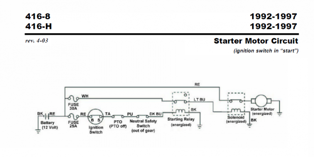

rmaynard 16,167 #11 Posted March 14, 2015 If you can trace a circuit, here is the "start" circuit for most 416-H's Looking at the above diagram, the power comes from the battery thru the 25A fuse to the ignition switch. Assuming the ignition switch is okay, when turned to "start", the power continues thru the closed PTO switch, and neutral safety switch to the coil of the start relay. If all is okay in that circuit, the relay closes applying power to the start solenoid. Physically check all the switches in that circuit to see if they are operating. Sometimes the motion lever fails to engage the neutral switch, or the PTO lever fails to properly contact it's safety switch. If you have a test light or meter, it's easy to see if they are working. Share this post Link to post Share on other sites
rmaynard 16,167 #12 Posted March 14, 2015 (edited) On my 1996 416-H, you do not have to be in the seat, or have your foot on the brake in order for the start motor to engage. However, not doing that will cause the engine to have no spark, therefore not start, but it should turn over. Edited March 14, 2015 by rmaynard Share this post Link to post Share on other sites
