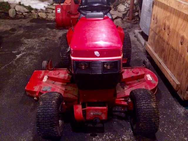

Brooksy 16 #26 Posted March 16, 2015 (edited) The deck is cut out in the middle also. Not sure if grass comes out there also or not. It just looked sweet lol my bad Edited March 16, 2015 by Brooksy Share this post Link to post Share on other sites
Theroundhousernr 590 #27 Posted March 16, 2015 (edited) NO problem . Just letting you know. There is baffles in the deck that surround the blades and direct all the grass out the side. If the deck is level the way it should , it all makes it out the side. If its not set and leveled properly, it will usually spit some out the front or rear depending on which way it is cocked. Because the deck height adjuster is on the left side . It is a 48 inch side discharge deck. If it was on the right, it would be a 42 inch side discharge. Great tractors you got though! I also find weird stuff like the deck shape aesthetically pleasing on a wheel horse. Every see a deck on a snapper! Edited March 16, 2015 by Theroundhousernr Share this post Link to post Share on other sites
Brooksy 16 #28 Posted March 16, 2015 Ahhh just went out and looked I see what your talking about haha. Yea can't wait to get them out this year excited to see how the 48inch deck does compared to my 60inch deck I have for my HC. Love the sound of that thing at 3500rpms!! Share this post Link to post Share on other sites

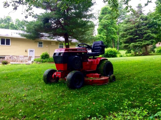

Theroundhousernr 590 #29 Posted March 16, 2015 Here's the result of my 48 inch deck on my 520. No mods. Sharp blades, setup up according to manual and moderate mowing speed. Love the black rims on that 520HC. Looks pretty mean. 1 Share this post Link to post Share on other sites
Brooksy 16 #30 Posted March 16, 2015 (edited) Yea I can definitely tell the differences between the two. The HC is way wider in the front bigger tires. Obviously the 60incb deck. Also doesn't come with the hub caps or chrome air cleaner lid and the dummy light board is a little different and the HC doesn't have the clutch disengage lever. HC is also a lot faster. Was told the HC is rare is this true? Hell yea grass looks great in that picture can't wait to try mine out!! Edited March 16, 2015 by Brooksy Share this post Link to post Share on other sites

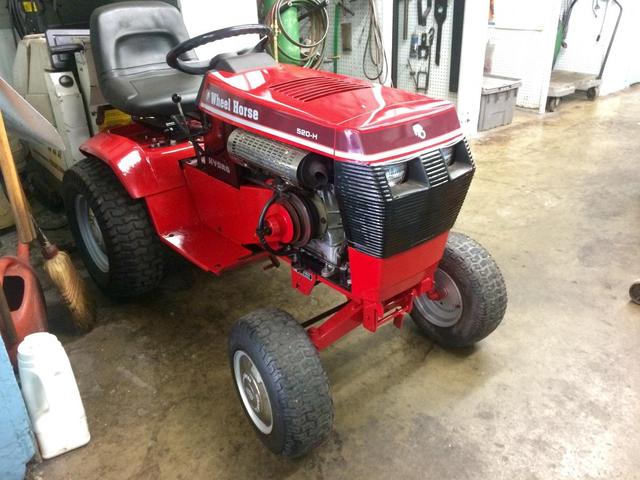

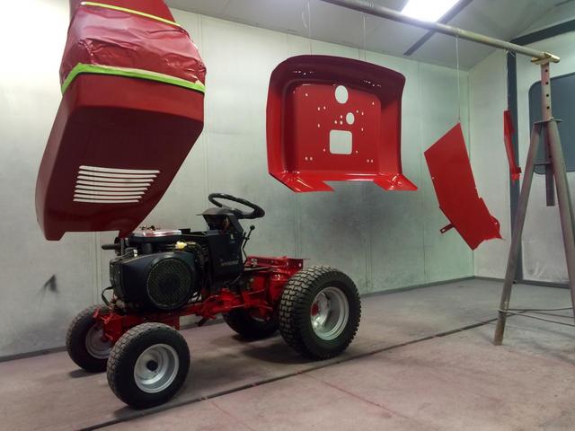

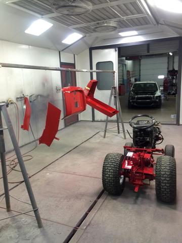

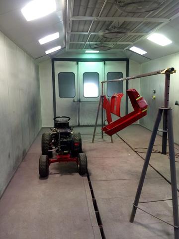

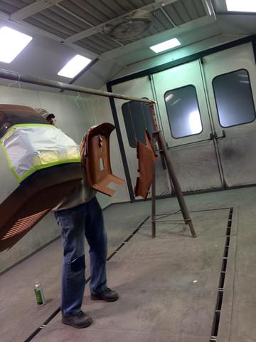

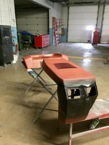

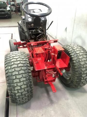

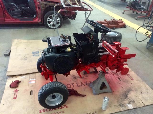

Brooksy 16 #34 Posted March 23, 2015 (edited) So started to tear down the 520h and paint it back to oem color. Going over everything in the process. Fixed the cracked frame and reinforced it back where the trans/dif bolt to the frame. Very solid tractor otherwise. Hopefully get to put it all back together soon! Everything hanging up was sprayed with the gun rest was rattle can Edited March 23, 2015 by Brooksy 1 Share this post Link to post Share on other sites
Theroundhousernr 590 #35 Posted March 23, 2015 Since your going through all this nice work. I would service that onan engine while your at it. Decarb and adjust valves. Share this post Link to post Share on other sites
Brooksy 16 #36 Posted March 23, 2015 Already adjusted the valves. Just run some seafoam threw it or what? I used my scope to look down in the spark plug hole didn't look to bad to me slight carbo build up nothing major. Had 120psi compression in both cylinders I was really happy about that haha. Planing on cutting holes in the belt guard to help the rear cylinder cool a little easier. 1 Share this post Link to post Share on other sites
Theroundhousernr 590 #37 Posted March 23, 2015 How do the cooling fins look? I would at the least clean them up. Easy way to check is pull the regulator off and peer down the hole with a flashlight. Share this post Link to post Share on other sites
Brooksy 16 #38 Posted March 23, 2015 Cooling fins look fine I degreased and presser washed everything when the covers were off Share this post Link to post Share on other sites
Theroundhousernr 590 #39 Posted March 23, 2015 Sounds like your ready to go! Things like that keep them onans running. 1 Share this post Link to post Share on other sites

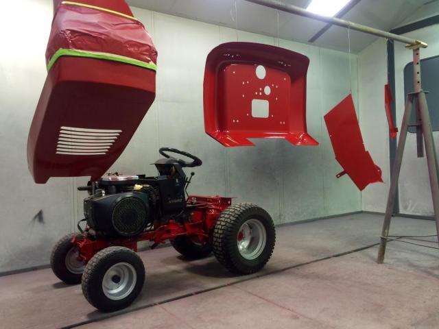

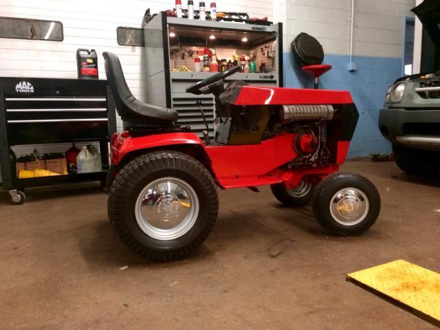

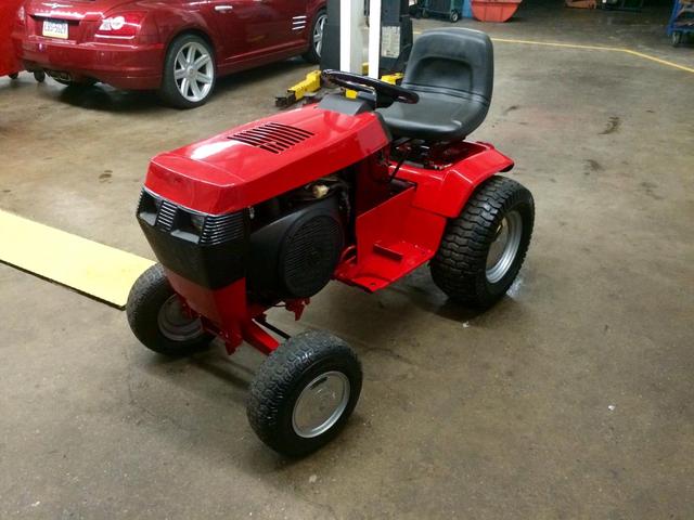

Brooksy 16 #46 Posted March 26, 2015 Almost done. Just the deck and decals to do yet. 1 Share this post Link to post Share on other sites
Ken B 3,203 #47 Posted March 26, 2015 That turned out real nice, the new decals will really make it pop! If I had to GUESS it looks as though you work in a body shop... NICE. Share this post Link to post Share on other sites
Brooksy 16 #48 Posted March 26, 2015 Thanks! I'm a automotive technician but there is a body shop on the other side of that wall behind my tool box. Had one of the guys over there spray my hood, fender, and two side panels. The rest was rattle canned. Decals are here I'll post some pics once there on Share this post Link to post Share on other sites

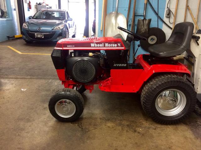

Brooksy 16 #49 Posted March 26, 2015 Decals went on very easy. Very happy how they came out. 2 Share this post Link to post Share on other sites
