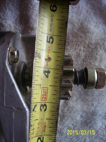

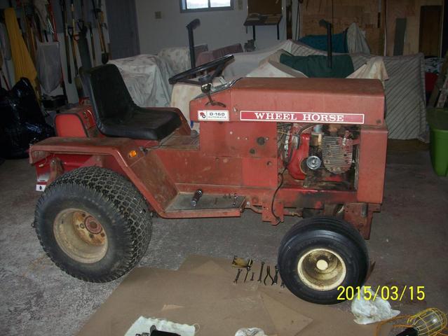

rockinhorse 45 #1 Posted March 9, 2015 OK to start with i have no experence with the D's or Onan engines. I got a D-160 the guy said the starter was bad. He said he had problems getting the starter out had to take engine loose and push it forward and move a lot of stuff to get it out. Is there a easy way to get the starter out without taking the whole engine apart. I took the one shield around the oil filter off. He told me i would have to take oil filter and drip shield off. I looked at shourd around flywheel and cannot see any bolts holding it on. He said starter would stick into flywheel when trying to startand have to pry it out (off) of flywheel. The owners manual say's it's a BF engine. If you have any ideas let me know? I was looking a owners manual and if it had been a Kohler engine it would be easy to replace. 1 Share this post Link to post Share on other sites

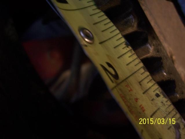

rockinhorse 45 #7 Posted March 15, 2015 Well i got the starter off. Psalms83:18 it took me longer than you. I could not get the oil drip plate to come off until i got the top starter bolt out. I will get pics tomorrow but it looks like the wrong starter . The teeth on the starter are a lot bigger than on the flywheel. Does any body have a picture of a starter off of a D-160 with Onan engine. I am just about convinced that this will be the last Onan engine i will ever own. Share this post Link to post Share on other sites
boomers_influence 106 #8 Posted March 15, 2015 rock if your starter is correct for a BF it should have TEN teeth. thank you. boomer ( the used onan engine parts guy, also NOS and new ) 1 Share this post Link to post Share on other sites
rockinhorse 45 #9 Posted March 16, 2015 OK the starter is off here are some pics of starter and flywheel. Starter teeth look to be 1/2" apart , flywheel look to be around 3/8' . why they put the started bolts there ? Let me know what you think if this is the right starter ? Thanks Karl Share this post Link to post Share on other sites
psalms83:18 174 #10 Posted March 16, 2015 (edited) That looks exactly like mine. Though I didn't count any teeth. Also look back at my thread a couple down the list I got some pics of mine in there. That oil filter mount thingy is still on the engine in your pics I had to take that off for more room. But at least you didn't have to take the whole engine off and apart. And I could of been underestimating a little with my time! 😇 Edited March 16, 2015 by psalms83:18 Share this post Link to post Share on other sites

rockinhorse 45 #12 Posted March 20, 2015 OK guys got the tractor running good went out tonight to take pictures. I turned the key on the starter made a big noise and fell on the floor. psalms83:18 the started broke in the same place yours did. And it was running so good this ONAN does not like me . Do i have to get a new starter or can i get the bracket? Share this post Link to post Share on other sites
