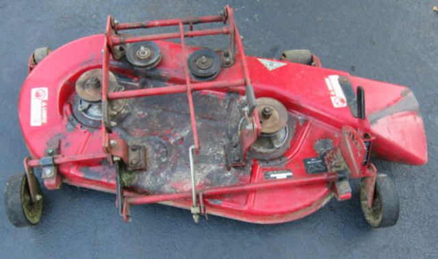

daveoman1966 3,841 #3 Posted March 9, 2015 (edited) does your deck look like this one? please contact me by direct email.....send to: daveoman@windstream.net Edited March 9, 2015 by daveoman1966 Share this post Link to post Share on other sites

localdj77 11 #9 Posted March 10, 2015 This is the deck for sale......any thoughts? Model? Size? Share this post Link to post Share on other sites
bmsgaffer 2,053 #10 Posted March 10, 2015 (edited) Looks like its missing parts of the carriage where it mounts to the tractor. There should be a decent amount of those around to get one though. I dont have much idea of model, but it is attachmatic. I think 42" is the one with the adjuster on the same side as the chute, I would have to double check this though... Edit: it is a 42". Looks like it may have been painted. May be worth a look if the metal is all still solid, hard to tell without flipping it over though. Edited March 10, 2015 by bmsgaffer Share this post Link to post Share on other sites
localdj77 11 #11 Posted March 10, 2015 It looks in decent shape. Could I swipe the carriage from my 37" deck? Will my 12hp do ok with a 42" I would rather finish rebuilding mine considering I've already bought all the parts.....I hope Dave contacts me back soon. Share this post Link to post Share on other sites
bmsgaffer 2,053 #12 Posted March 10, 2015 I do not think yours will swap. The 37" was sort of an odd-ball in the attachmatic world, thats why it needed the smaller front wheels. I had a 10hp that cut 1.2 acres with a 42" for over 15 years, so the 12 will swing it no problem. If you have already put some work into the 37 I would keep it, Dave should be getting back with you soon if he has your parts. If not post a wanted ad, I'm sure someone will have some. You may want to consider putting new bearing in the spindles if you have it torn this far apart if there's even the slightest hint of grittiness. Good insurance, but thats up to you. Share this post Link to post Share on other sites

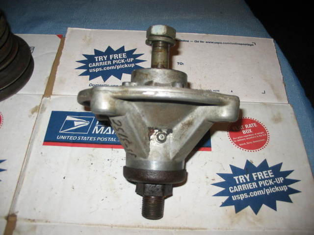

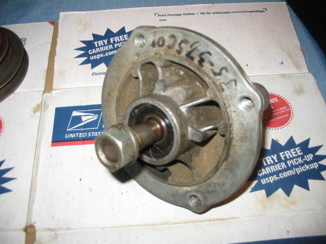

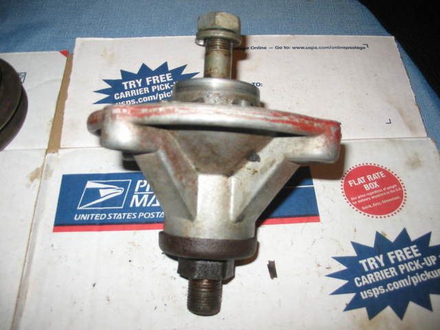

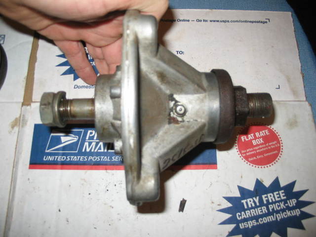

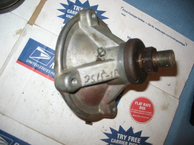

daveoman1966 3,841 #17 Posted March 10, 2015 I have the spindle you asked about. Here are a few pics. I am also sending a PM to you with further details. I did get your off-site email to me, and I replied biut got no answer. 2 Share this post Link to post Share on other sites
