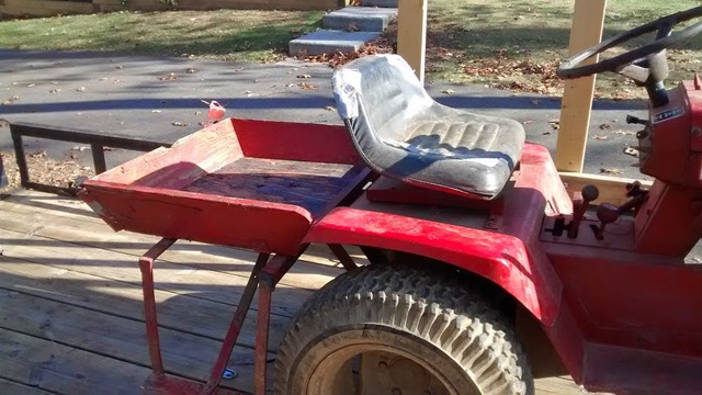

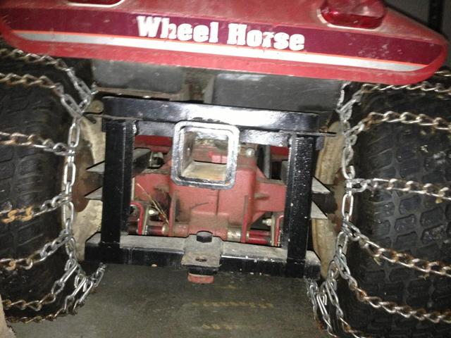

Forest Road 595 #1 Posted March 8, 2015 I've had a few requests over the years for close ups. As with life it's just something I tend to forget. It started with a Scotty Moreau built 3" receiver hitch. And an old WH ballast box I had laying around. Some 2" square tubing and 1/2" plate a little time welding and here she is. During the winter it carries 4-44lb suitcase weights and 5 gallons of gas. I usually take it off for mowing duties. It's been pretty handy when I have a tree down. It's just the right size for a chainsaw, fuel. And oil. Sent from my iPhone using Tapatalk 11 Share this post Link to post Share on other sites
Navig8r 132 #2 Posted March 8, 2015 Looks good... But ya gotta paint those weights! 1 Share this post Link to post Share on other sites
rmaynard 16,972 #3 Posted March 8, 2015 Sort of reminds me of the "trunk" of my B-60. 6 Share this post Link to post Share on other sites

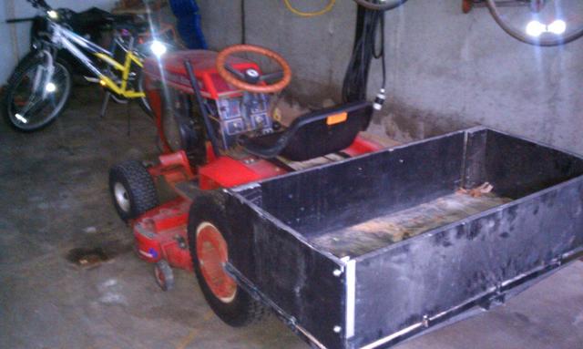

Tim 97 #4 Posted March 15, 2015 here's mine, took a home made cargo carrier for my car and made and boxed it the hitch is made from a tracvac rear hitch with a 2" receiver welded on 3 Share this post Link to post Share on other sites
Forest Road 595 #5 Posted March 16, 2015 Looks good... But ya gotta paint those weights! Nope. Just a reminder that a horse works best carrying dead weight. Sent from my iPhone using Tapatalk 4 Share this post Link to post Share on other sites

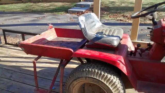

JackC 618 #6 Posted March 24, 2016 Nice quick attach / detach design. The QuickWay weight box bolts on and makes it difficult to go up or back down a ramp without scraping the back of the box and bending the towing tab on the back of the box. 1 Share this post Link to post Share on other sites
