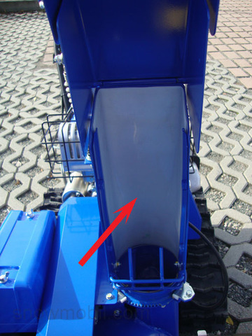

shallowwatersailor 3,222 #33 Posted February 13, 2016 It is Winter and some of my time lately has been spent on one of the snowblower forums. I have had additional thoughts on lining the chute. Yamaha manufacturers walk-behind snowblowers that are not imported to the USA. One thing that they do is line the rear of thechute with a teflon plastic. There is a supplier on the popular auction site that sells UHMW sheets. The thinnest that they sell is 1/16" which might be able to be bent to conform with the chute. The other thought I have had is to see if there is a way to eliminate the "step" at the throat of the chute. If you look at how the snow exits the auger housing/bucket, the snow is directed to the rear portion of the chute. It seems that some snow is allowed to tumble at that point which leads to clogging with wet snow. The UHMW could be spaced out from the rear metal to allow a smoother transition. 2 Share this post Link to post Share on other sites

shallowwatersailor 3,222 #35 Posted February 13, 2016 Don, I agree that the deflector seems to be a double edge sword, needed for distance but an obstruction with wet snow. My thoughts are that the smoother the transition the less friction is created. If you look at the Yamaha photo closely, it appears that the liner conforms to the throat. There isn't a deflector but it does have a guard across the throat, I assume, to prevent large projectiles or a hand going down it. Granted this is a two-stage blower[. The clogging of wet snow seems to affect the single-stage snowthrower more. Maybe a liner would alleviate the use of a spray. Share this post Link to post Share on other sites
