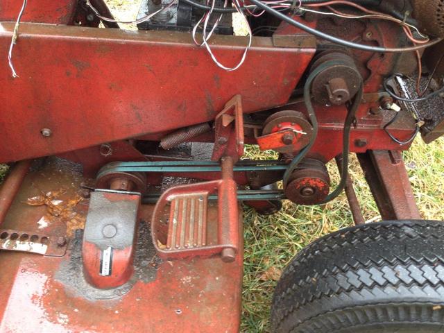

Bobster 19 #1 Posted March 3, 2015 Does anyone have a manual, diagram or check list for removing a mower deck from my 857. I have never dealt with it and know you guys would know the easy way. Thanks, spring is on the way. Share this post Link to post Share on other sites
squonk 45,591 #2 Posted March 3, 2015 Un do the belt. Remove the rod from the deck at the lift arm. On left side of tractor you will see a kind of triangle plate hanging down in line with the shaft that front pulley rides on. Swivel that plate thingy towards the rear and that shaft/pulley will drop. slide out the deck from under the tractor. Share this post Link to post Share on other sites
