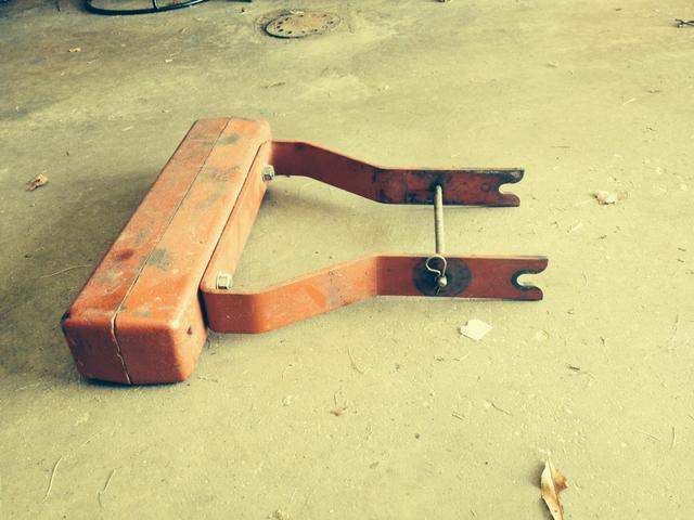

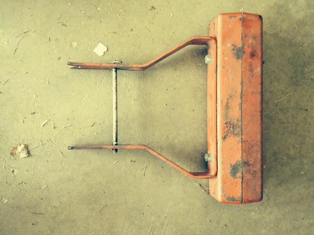

oe espo 32 #1 Posted March 2, 2015 I was wondering if the OEM front weight system will work with snow plowing? I picked up a set of OEM front weights but with Turf the don't seem to be helping much on asphalt. I don't have the front bracket pictured but was going to make it. Will it work or interfere with plow? Also thinking about a set of V61 Vredensteins but the front weight bracket will be cheaper. Any input appreciated. Using both 312A and 520H which isn't completely back together yet. 1 Share this post Link to post Share on other sites

oe espo 32 #8 Posted March 2, 2015 The picks of the factory weight were taken at the guys house I got the 520 and snow plow from. He wanted to keep it. So it sounds like it helps. Share this post Link to post Share on other sites

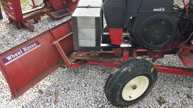

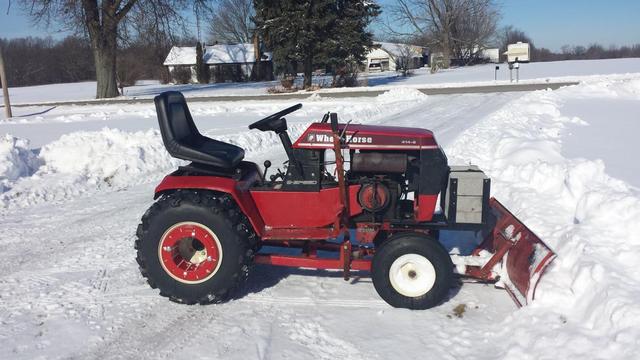

diamondred 63 #19 Posted March 6, 2015 this works... better shot. Share this post Link to post Share on other sites

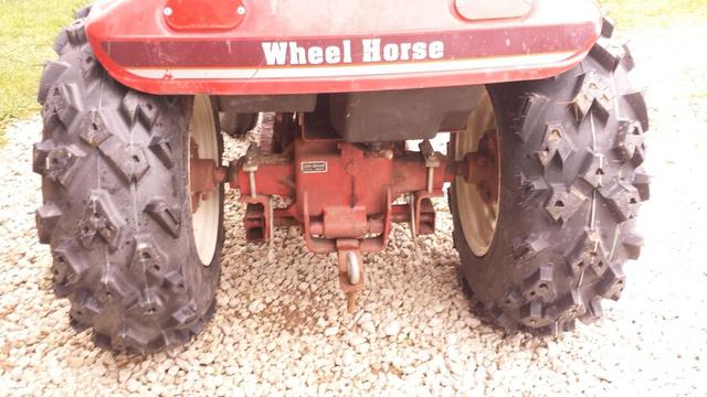

oe espo 32 #20 Posted March 6, 2015 (edited) I ordered a set of V61 16" x 6.5 Wide. Should be here monday. keep the pictures coming. lots of ideas out there. thanks everyone! Diamonred: First those RED wheelweights look great and funcitonal of course. What are those rears you have? You like them. I'm running chains and turfs on asphalt. Someday be buying rear tires. I got a set of loaded AG's on my 312 only 8.5 wide almost 90lb each. Wonder if there better than chains turfs. Any idea how much weight you got out front? Ever snap a bolt? Edited March 6, 2015 by oe espo Share this post Link to post Share on other sites
pfrederi 19,460 #21 Posted March 6, 2015 this works... better shot. How do you open the hood to check the oil or can you get to the dipstick with out opening hood?? 1 Share this post Link to post Share on other sites
diamondred 63 #22 Posted March 7, 2015 (edited) I ordered a set of V61 16" x 6.5 Wide. Should be here monday. keep the pictures coming. lots of ideas out there. thanks everyone! Diamonred: First those RED wheelweights look great and funcitonal of course. What are those rears you have? You like them. I'm running chains and turfs on asphalt. Someday be buying rear tires. I got a set of loaded AG's on my 312 only 8.5 wide almost 90lb each. Wonder if there better than chains turfs. Any idea how much weight you got out front? Ever snap a bolt? I got the tires here: www.rockymountainatvmc.com/p/1131/31262/STI-Black-Diamond-XTR-Radial-ATV-Tire and seem to work great til they hit ice , then they're done. I probably will go with turf tires and a good set of chains next year for winter. then use these to pull a plow in the garden Edited March 7, 2015 by diamondred Share this post Link to post Share on other sites
diamondred 63 #23 Posted March 7, 2015 (edited) How do you open the hood to check the oil or can you get to the dipstick with out opening hood?? Yeah, I got to remove at least two blocks to get the hood open enough to grab the dip stick. Design flaw...lol. But I have to say , those rib tires grab good with the extra weight! Edited March 7, 2015 by diamondred Share this post Link to post Share on other sites
