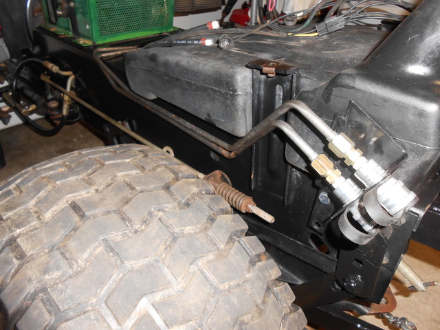

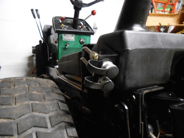

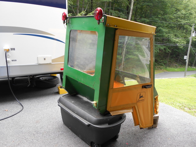

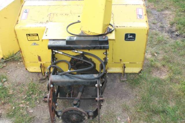

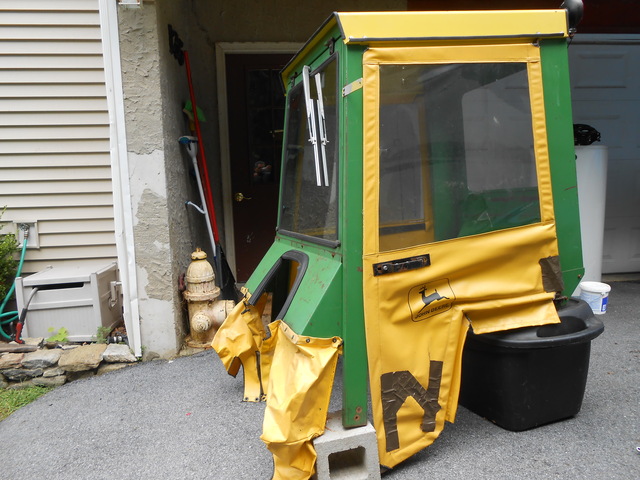

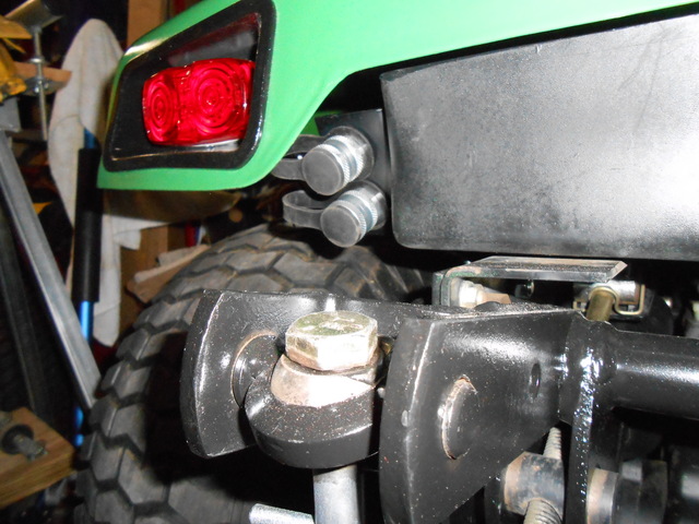

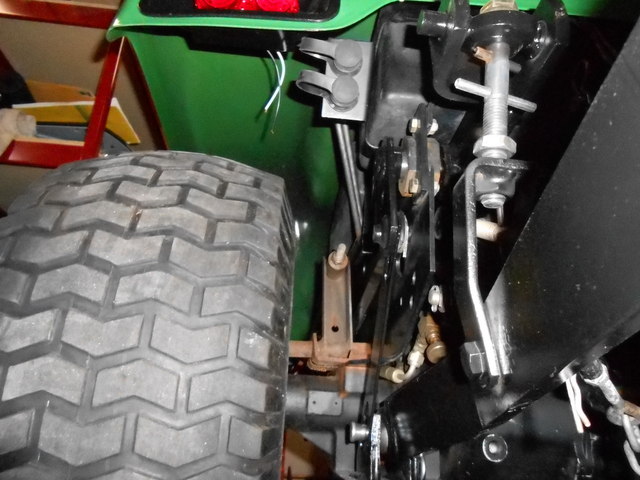

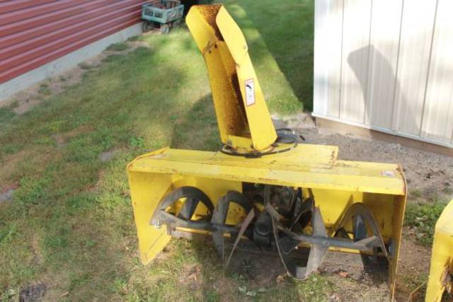

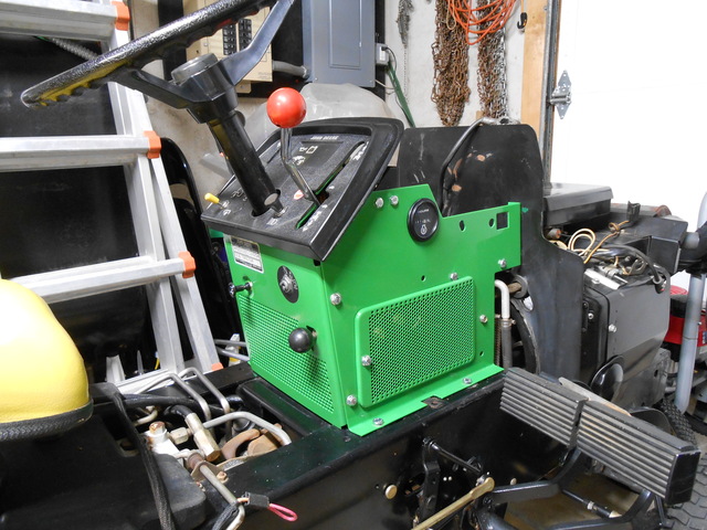

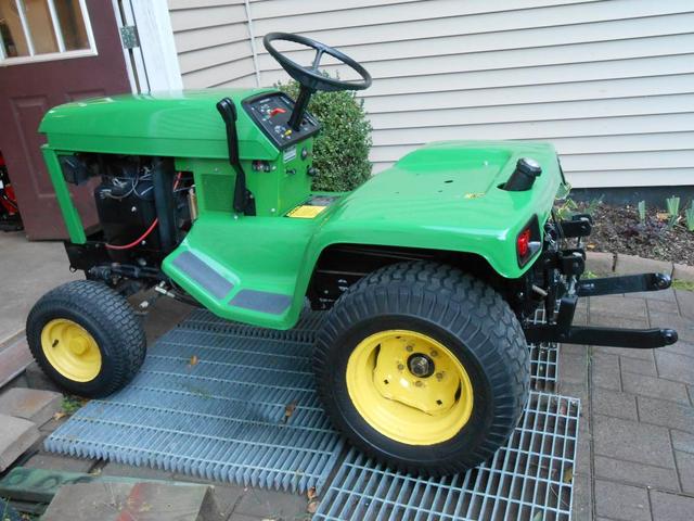

fireman 1,022 #28 Posted October 4, 2015 So since the last update, I added some other things. Picked a NOS rear hydraulic port kit and got that installed. I also picked up a nice snow cab. Going to replace the vinyl on the doors with 3/16" lexan along with the back window. I finally got the control console torn apart, repainted all the sheet metal, replaced all the hardware, throttle cable, choke cable and decals with NOS parts. As of tonight this is all re-assembled and ready to drive it around the house and into the work shop so I can put it on the lift and give it a service before the snow flies. Over on the JD website I posted in the wanted section looking for a 2-stage blower for it. I fellow member let me know of 2 in South Dakota and I ended up getting one of them. The seller is gonna put it on a pallet and drop it off at his local Fastenal for me this week. Now i'll really be able to launch some snow! Here are the latest pics:This pic shows the console re-assembled and ready to be started up. Share this post Link to post Share on other sites

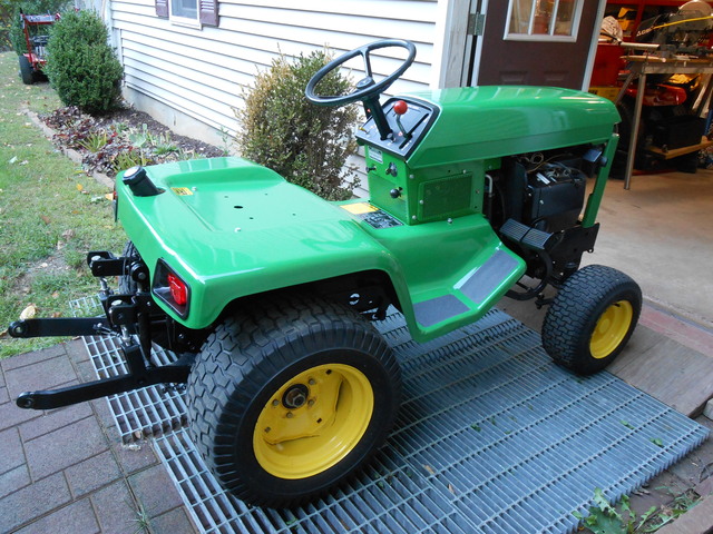

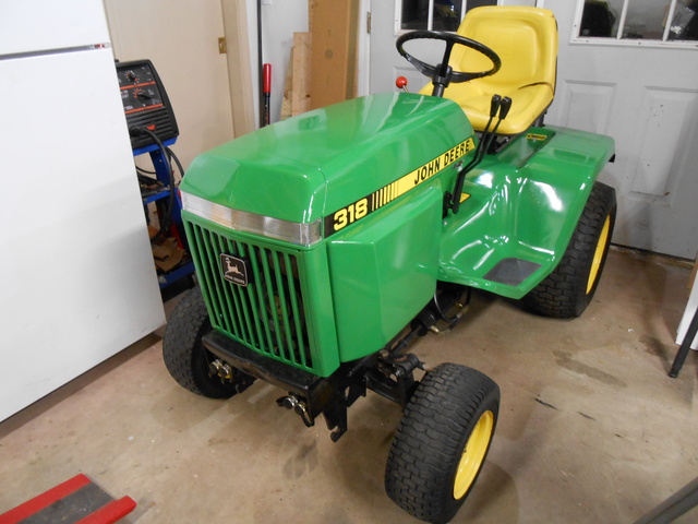

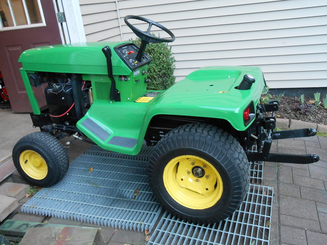

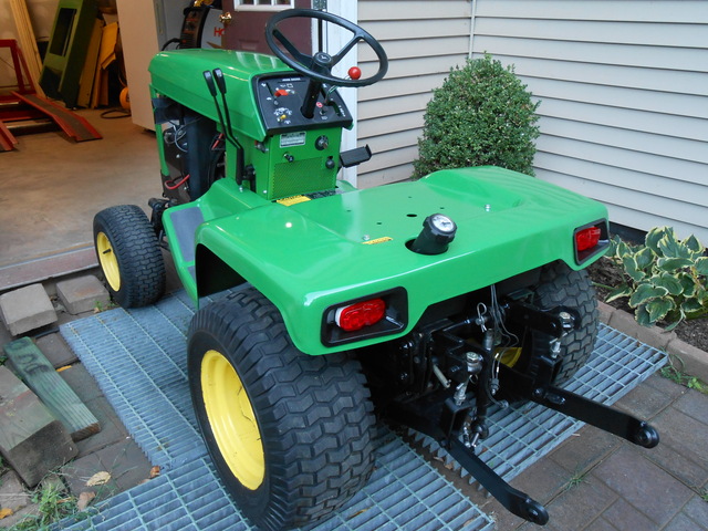

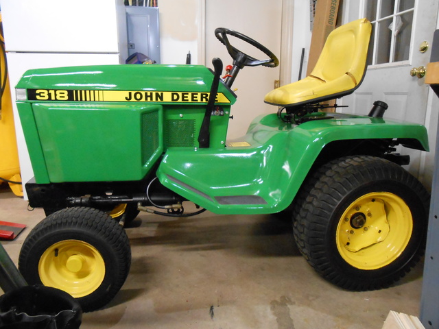

fireman 1,022 #29 Posted October 4, 2015 So after not running the tractor in like 4 months and putting on the new throttle and choke cables I rolled it outside and it fired right up with no adjustment of the cables needed.Let it run for a little while and drove it around a little then over into the workshop. I installed the spacers that came with the rear hydro outlet kit that lifts the rear of the seat pan allowing access to the connectors. I set the seat pan in place and tried the bolts to make sure everything lined up. Then I added the new decals, anti skid foot mats and installed the light bezels with new L.E.D. lights. Slipped the hood on and rolled it outside to take some pictures. The green looks a little lighter then I would have liked but oh well. I have to keep reminding myself this is a worker and not a show tractor! I'm going to replace the fuel lines and pick ups before I permanently install the seat pan. Still need a new headlight lens and 3 new L.E.D. bulbs for the headlights. Also need to replace my seat and tires. The seat is cracked really bad plus I want armrests. Now just to finish this up and move on to the cab. 3 Share this post Link to post Share on other sites
Sparky-(Admin) 26,267 #30 Posted October 4, 2015 It definitely looks nice Jeff!You said you installed the new decals? No pic with those installed?Mike......... Share this post Link to post Share on other sites
stevebo-(Moderator) 8,742 #31 Posted October 5, 2015 Someone did a nice job painting that bad boy... 1 Share this post Link to post Share on other sites
Ken B 3,203 #32 Posted October 5, 2015 Looks real nice Jeff! Share this post Link to post Share on other sites
fireman 1,022 #33 Posted October 5, 2015 Mike,I only put the decals on the seat pan and control tower as I had already clear coated them. I still need to clear coat the hood so once that is done and dry I'll put the long decals down each side of the hood. I actually cleared coated the underside of the seat pan this morning. This way it's protected from mud, dirt snow etc. Someone did a nice job painting that bad boy... Gee! I wonder who that could have been . 2 Share this post Link to post Share on other sites

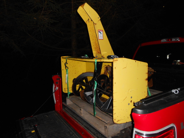

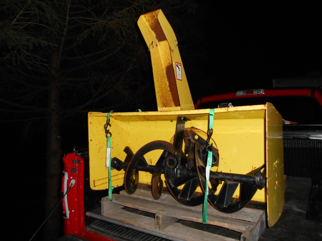

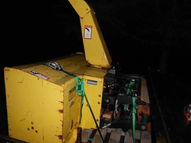

fireman 1,022 #39 Posted October 16, 2015 I picked up the snowblower from the Fastenal store I had it shipped to. All I can say is that if you ever need to ship something large, don't hesitate to use Fastenal. They are very inexpensive and it's painless to set up a shipment. It cost me $175 to ship this from South Dakota to Connecticut. The seller dropped it off last Tuesday and it arrived here Yesterday. They even used their forklift to load it in my truck. This beasts shipping weight was 525lbs. Lets take 25lbs off for the pallet and this blower comes in at 500lbs! That's just ! I should have enough ballast. I've got the two rear wheel weights that weigh 90lbs each. Next I have 8 suitcase weights that are 35lbs each that will go out on the 3 point hitch. Then I have the cab which I guess weights around 80lbs or so and then my weight. I also plan on mounting my small 2000 watt generator on the 3 point hitch so I can run a heater in the cab. With all of that I should be good on the counter weight.The snow blower has it's own hydraulic piston for raising and lowering. It also uses a hydraulic piston and pulley/cable system for the chute rotation. I plan on putting a 12volt actuator on for the tilting of the chute tip. Lets hope this chucks snow as far as some of the same ones I've seen videos of on youtube! 1 Share this post Link to post Share on other sites
shallowwatersailor 3,222 #40 Posted October 16, 2015 Nice work! I'm anxious to see how you recover the doors with the Lexan. Share this post Link to post Share on other sites
stevebo-(Moderator) 8,742 #41 Posted October 16, 2015 That is a big boy. My question is how do you plan on getting it off the truck? 1 Share this post Link to post Share on other sites
fireman 1,022 #42 Posted October 16, 2015 That is a big boy. My question is how do you plan on getting it off the truck? I was thinking about that too. Then I remembered my mother-in-law still has her late husbands engine crane at the house. I'll go get that tomorrow and use that to get it off the back of the truck. Share this post Link to post Share on other sites

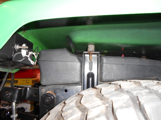

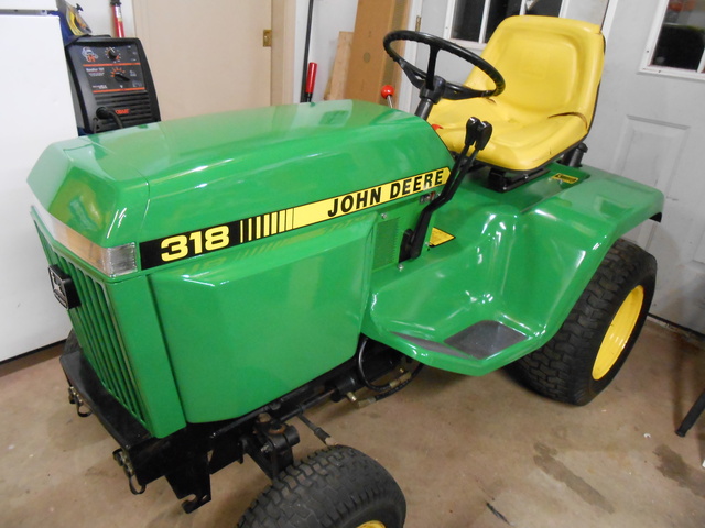

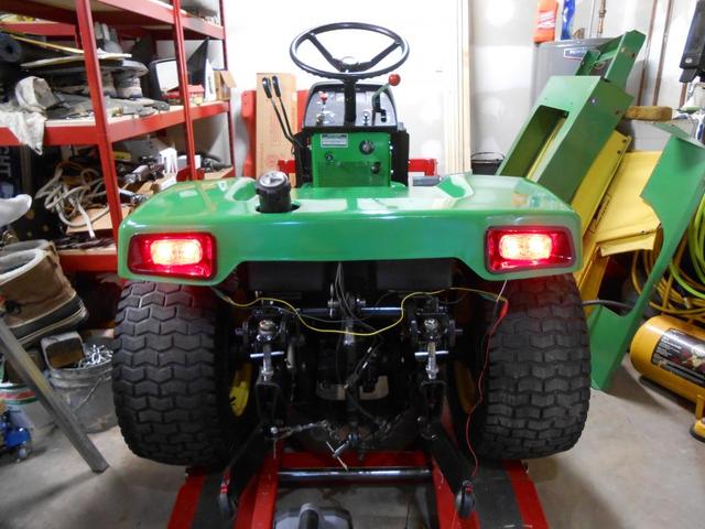

fireman 1,022 #45 Posted October 21, 2015 I finally got all the tins clear coated and put them on for a test fit. All thats left to do is replace the fuel pickups, lines and tank bushings then the seat/fender pan can get installed for good. I really like having arm rests on my seats and haven't found one I like yet so the cracked original will do for now. Still need some tires which I will order this week. It's all coming together but Winter is coming quickly. 3 Share this post Link to post Share on other sites

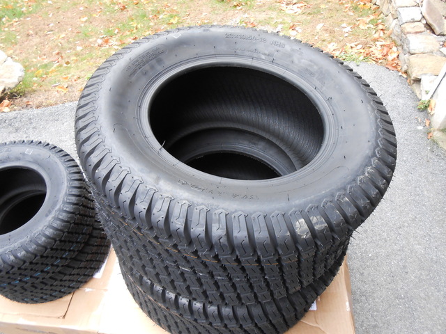

RedRanger 1,470 #47 Posted October 22, 2015 What tires are you going with??? Share this post Link to post Share on other sites
fireman 1,022 #48 Posted October 22, 2015 23X10.50-12 in the rear and 16X6.50-8 up front. Both are 4 ply plus I plan on running tubes all the way around. Share this post Link to post Share on other sites

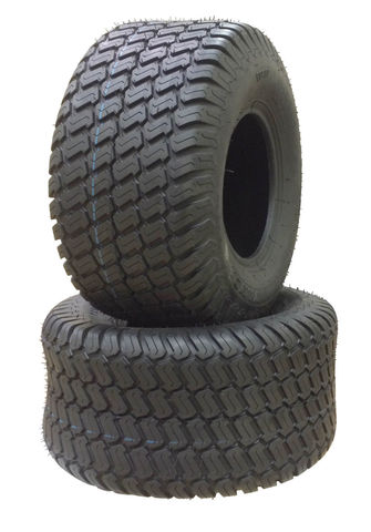

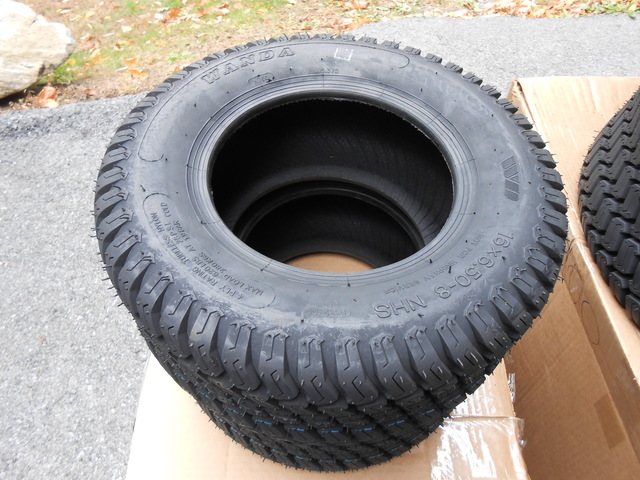

fireman 1,022 #49 Posted October 24, 2015 Found a smokin' deal for tires on Ebay. The name on them says "WANDA" but let me tell you I can see no difference between them and Carlisles. They are 4 ply and have the same weight ratings etc. The cost was $175 delivered for all 4! I bought them on Wednesday the 21st and they showed up today Saturday the 24th. If anyone is interested in the sellers Ebay name, PM me and I'll send you the link (Not allowed to post it here). Share this post Link to post Share on other sites
Sparky-(Admin) 26,267 #50 Posted October 24, 2015 Wanda?? Never heard of em but for something that only goes 7mph they are perfect!The whole machine is looking good Jeff.Mike............ Share this post Link to post Share on other sites
