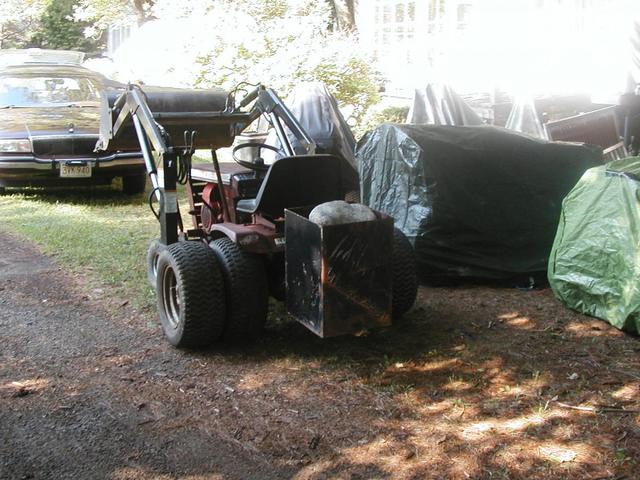

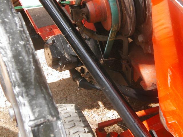

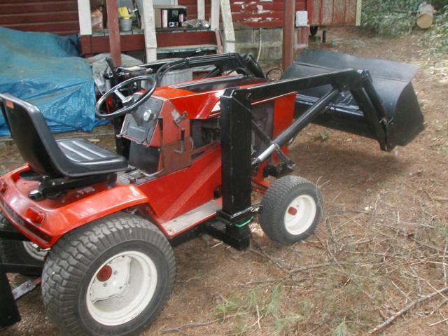

JackC 618 #5 Posted March 6, 2015 Here is the pump for the loader on my C-175. I have the same set up on 8hp C-81 and it works just as well. The pump runs off the PTO. Eight horses under the hood can do a lot of work on a Wheel Horse tractor. The C-81 has dual wheels on the back for stability on inclines. 1 Share this post Link to post Share on other sites
